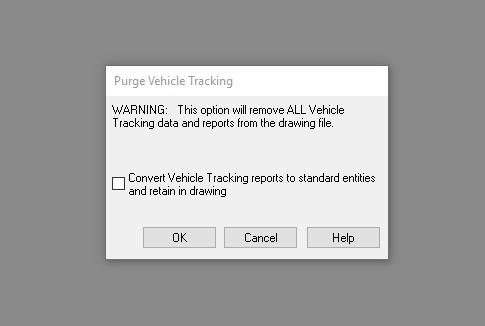

dweafer Posted May 22, 2019 Share Posted May 22, 2019 (edited) Hi all, We are having serious issues with AutoCad 2019 in our office. I have decided to switch back to 2016. Our IT had advised that all drawings were to be saved as a 2018 version. I have saved my 200+ drawings back to 2013 version. But when opening I receive a pop up warning about vehicle tracking which "purgevehicletracking" gets rid of when used. Can anyone help with a script or lisp code what will press the OK button after the command "_purgevehicletracking". I want to be able to use this across all my drawings. Edited May 22, 2019 by dweafer mistake on warning Quote Link to comment Share on other sites More sharing options...

dweafer Posted May 23, 2019 Author Share Posted May 23, 2019 52 minutes ago, dlanorh said: Trying to find out if any of the buttons is_default is set. the default is to cancel the command, I tried to 'tab' and 'enter' in a script which works in order of manual entry. but has no luck when running. I would not have much knowledge for writing code, so I was trying this in a script format and trying to use Scriptpro on multiple files. _purgevehicletracking "need to hit the ok button" I appreciate any help. Thank you. Quote Link to comment Share on other sites More sharing options...

dweafer Posted May 23, 2019 Author Share Posted May 23, 2019 Hi rlx I am only trying to run one command 'purgevehicletracking' then press 'ok' on the pop up window for this command. purgevehicletracking - enter Press ok button press ok button qsave Pardon my ignorance but I am not great when it comes to this type of stuff. Quote Link to comment Share on other sites More sharing options...

dweafer Posted May 23, 2019 Author Share Posted May 23, 2019 Tharwat The command works. The issue I am having, is that 2 text box alerts pop up when I execute the command the first with 3 options. I need to hit 'ok' to agree to continue the command and then another alert to which there is one option to press ok to continue. Its fine manually entering this but every drawing in the office which has been opened in 2019 needs to have the vehicle tracking purged in 2016. its a hicup like the proxy graphic information showing up when opening a drawing although this can be turned off. Its an annoying issue not a critical issue. But I can not batchplot drawing because of it which is an issue. Quote Link to comment Share on other sites More sharing options...

dweafer Posted May 23, 2019 Author Share Posted May 23, 2019 Strangely the hyphen disappears when I hit enter. Its not reacting the same as '-purge' would to just 'purge' the pop still appears and it does not show an option for the hyphen command. Quote Link to comment Share on other sites More sharing options...

dweafer Posted May 24, 2019 Author Share Posted May 24, 2019 12 hours ago, dlanorh said: Left field and probably won't work, but what is sysvar "filedia" set to? If it = 1 set it to 0 (zero) and see if the dialog still pops up or it goes to command line. If it doesn't work then reset it to 1 otherwise no dialog's for a lot of commands. Thanks dlanorh, I had tried this with no luck. The popups still appear when windows are suppressed when filedia is set to 0 Quote Link to comment Share on other sites More sharing options...
