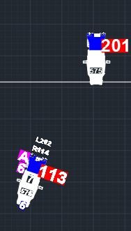

Hi I have a lisp that auto numbers attributes  in a multi attribute block by its tag. when I export and import the data back after editing it in excel, the lisp will not let me edit the blocks again. If I drop in the same block new in the same drawing it works fine on the new block. I don't get any errors on the command line. It just doesn't change the value.  I can still edit the blocks manually, but the lisp will not work. Any help is greatly appreciated.

I tried it and get an error. It works the same will work with new blocks inserted but will not edit/update anything that has been changed with a data import.  Something is definitely locked. I am using express tools attribute import/export. It does it when the information changes. Not the import export function.  I also have many block types that have the same tags. It effects them all.

The drawing you posted , is it a drawing were the error occures? Else post a drawing after it was processed with express tools and generates the error.
Edited by rlx
Hi;
That gets rid if the error, but it still doesn't update the data transferred block. It skips over it. It says it does in the command line.

I really can't reproduce your error... strange... regenall maybe? or try audit the drawing. Only other thing I could try is to re-write it to use vla-put-string etc instead of vanilla lisp. Or can you try on another computer to see if it has something to do with the autocad installation.
ah, I can reproduce the error... will try a different code just gimme a minute...

Awesome that unlocked it. Thanks! How would you change this to work will this work with all blocks? I have probably over 50 with the same attributes but are different block names and symbols. I also have to number them in selection order regardless of block type.

This works perfect. Thank you.
