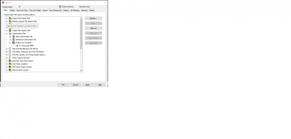

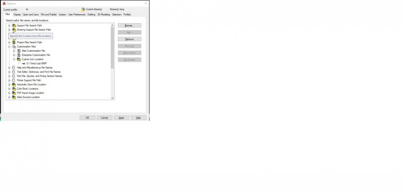

Costinbos77 Posted May 18, 2019 Share Posted May 18, 2019 (edited) Hello everyone ! 1. I am creating the .mnu , .mnr , .cuix file using AutoLisp and are stored in a new folder as : C:\Users\PCjohn\AppData\Roaming\Autodesk\AutoCAD 2019\R23.0\enu\Support\Topo MNU 2. In previous AutoCAD versions ( older than 2019 ), I am using the below way to define a custom Toolbar : .mnu file ***MENUGROUP=MENIU_Topo // ***POP16 **TOPO_MENIU ....... ***TOOLBARS // **TB_TOPO_U // ID_TbTopo [_Toolbar("Toolbar Description", _Top, _Show, 200, 350, 1)] ID_Comd1 [_Button("Description Comd1", "C:/Topo/Icon/Comd1.bmp", "C:/Topo/Icon/Comd1.bmp")]^C^C_Comd1 ID_Comd2 [_Button("Description Comd2", "C:/Topo/Icon/Comd2.bmp", "C:/Topo/Icon/Comd2.bmp")]^C^C_Comd2 ID_Comd3 [_Button("Description Comd3", "C:/Topo/Icon/Comd3.bmp", "C:/Topo/Icon/Comd3.bmp")]^C^C_Comd3 . . . mnuFilePath = C:\Users\PCjohn\AppData\Roaming\Autodesk\AutoCAD 2019\R23.0\enu\Support\Topo MNU\Topo.mnu (command "_.CuiLoad" mnuFilePath) ; convert .mnu to .cuix file (menuCmd "P16=+MENIU_Topo.pop16") ; load custom Menu (command "_.ToolBar" "MENIU_Topo.TB_Topo_U" "t" "2,3") ; load custom Toolbar In AutoCAD 2000 to 2018 is working fine . In AutoCAD 2019 , when I create the Toolbar in the first instance it is ok . But in the following uses of AutoCAD , the icons pictures appear as a question mark (picture attached ) and not all of them . 3. What is causing this problem ? It is something wrong with the icons files path ? All the pictures are in the same folder . The old style of Toolbars is not accepted in the new AutoCAD ? Somehow , the bmp files can't be found by AutoCAD . Any ideas ? Regards , Costin Edited May 18, 2019 by Costinbos77 Quote Link to comment Share on other sites More sharing options...
