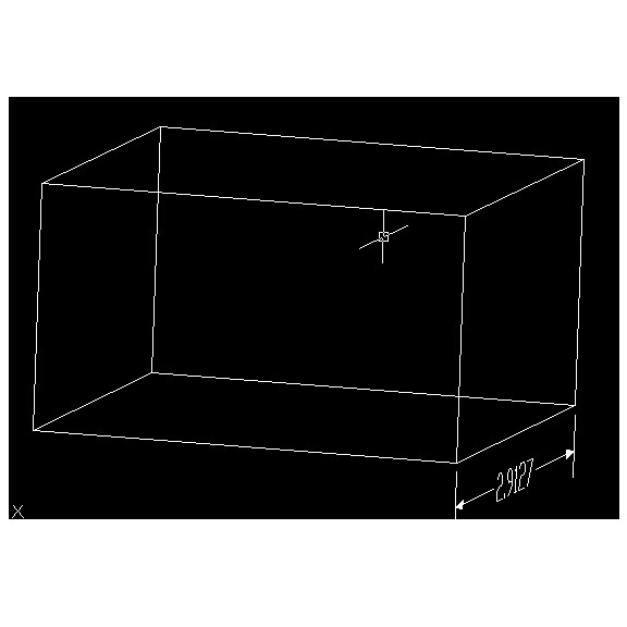

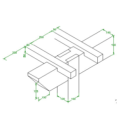

marlon Posted January 26, 2009 Share Posted January 26, 2009 When viewing in isometric projection, my dimensions look like this. How do I make it look like this Thanks!!! Quote Link to comment Share on other sites More sharing options...

marlon Posted January 26, 2009 Author Share Posted January 26, 2009 i want the dimensions to appear 'straight' or aligned with the screen. Notice in the first picture that the dimension appears sideways; that's not what I want. Quote Link to comment Share on other sites More sharing options...
totzky Posted January 26, 2009 Share Posted January 26, 2009 I have a problem seeing your posted image so it will be a long shot. Change your UCS to view. Quote Link to comment Share on other sites More sharing options...
marlon Posted January 26, 2009 Author Share Posted January 26, 2009 When you start autocad, draw a rectangle and give it a thickness (or extrude it). Then use "dimlinear" command to get the dimension of either the length or width. Then 'orbit' the rectangle. Your dimension (line and text) 'orbits' as well, i.e. you turn the rectangle to right, the dimension follows; if you turn it all the way to the right, you wouldn't be able to see the dimension because it's sideways already. What I need is to be able to provide dimensions that look like the second picture. Quote Link to comment Share on other sites More sharing options...
stevsmith Posted January 26, 2009 Share Posted January 26, 2009 change the ucs position to suit the direction of the dimension, you will need to experiment with the ucs to get the correct projection of the dim. The secon image looks like it has been done in an isometic projection in 2d not 3d. if this was the case then you will need to use oblique dimension. Quote Link to comment Share on other sites More sharing options...
