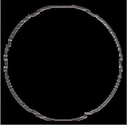

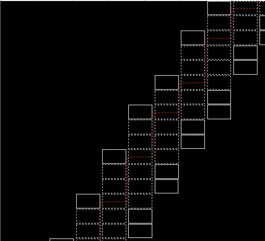

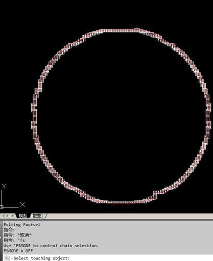

Rain0923 Posted May 14, 2019 Posted May 14, 2019 The problem as below 1.It needs to select many object so I use zoom and windows first then use fast select.(pic1) 2.I select red area but that many close red area selection too.(pic2&3) How to do solve this problem? Thanks Quote
rkent Posted May 21, 2019 Posted May 21, 2019 Are the red ones on a separate layer? If yes then lock the other layers and select all. Are the red ones assigned the color red (not on a layer with red color), then use filter option in properties, or filter command. Quote

CyberAngel Posted June 26, 2019 Posted June 26, 2019 You can use Quick Select to pick a specific color or layer or block. You can narrow down the search by selecting everything in a particular area first. You can run Quick Select as many times as you need to, picking a new filter each time. If you encounter this problem often, consider making a block out of object groups that occur widely and must be selected this way. If this doesn't help, please provide more information. Quote

tombu Posted July 10, 2019 Posted July 10, 2019 (edited) With ssx you can select entities of the same type, layer, and color. Then use Isolate Objects from the Status Bar so only what you want is displayed. I'd group them after that to make them easier to select next time. http://help.autodesk.com/view/ACD/2020/ENU/?guid=GUID-386ADF5E-C709-4940-8DB4-909C2760A23F Edited July 10, 2019 by tombu Add link Quote
