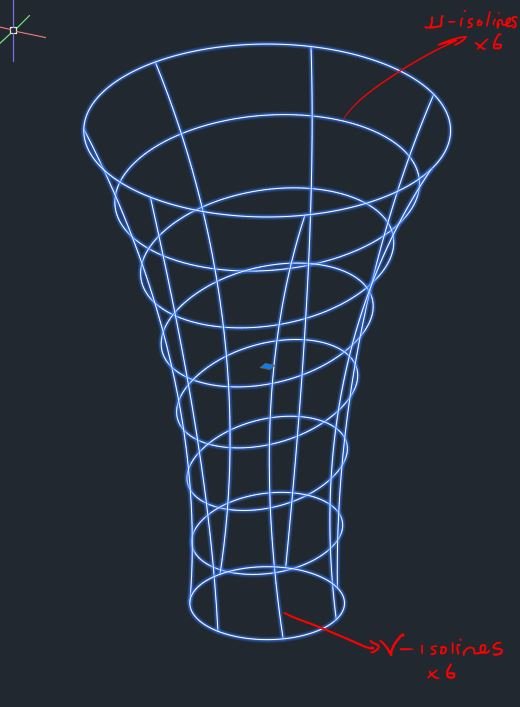

Hello Dear All,
I'm struggling since 3 years about that issue, maybe someone can help about it;
As you can see down below i have kind of vortex shape (surface) and would like to extract u and v isolines as polyline or spline for that extractisoline command just giving random splines, xedges command giving only top and bottom circles, if i convert that shape into mesh it's giving distorted mesh body, i can't also snap intersection of isolines to drawing with 3dpoly, i have no idea left can someone tell me what can i do more?
I just need exact position of isolines itself or intersection points.
Note: I found that script many years ago but won't work either!
Script:https://adndevblog.typepad.com/autocad/2014/03/extracting-isolines-from-surface.html
Thank you and Best Regards

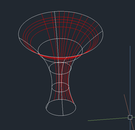

But i tried to rebuild something similar, with 3 circles, using loft to create a solid and then explode it to a surface that looks like your image.
i don't know how to get lines from a surface in autocad, but i tried Civil 3D, but it doesn't seem to recognize the object as a surface.  At least i can't extract any lines from it there either...
i do however found the command 'SURFEXTRACTCURVE' (works in regular AutoCAD too), where you can create your own (SP)LINES.  Using D(irection) to get the  Vertical and Horizontal plane.
White is exploded loft object,  the red lines are the ones that were extracted manually.

Thank you for your respond, that command 'surfextractcurve' in Civil 3d equal 'extractisoline' command  in autocad. Really cool tool but i need to snap exact isolines as i created not random isolines on surface. I hope one day i will find solution, nevertheless thank you
