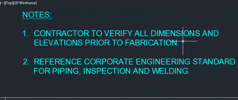

I want to add text to an existing MTEXT, but the utility I have used doesn't support what I am trying to do.
I can select it fine, but it doesn't come out right.
This is the old format:
This is the new format (this is what is desired):
This is the old text in properties:
This is the new text in properties (this is what is desired):
I tried to use this code to call a MRWA.lsp (but the format doesn't work right):

Am I just a few characters off to get this to work right?  Or do I need to take another path to make this work?

44 minutes ago, GregGleason said:
(vla-put-textstring o (string_subst (vla-get-textstring o) old new))
You never define what 'new' is?
This is the "new" text in yellow (with a couple of carriage returns).
Greg
