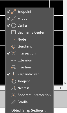

What steps   I have to do in order to have the below osnaps always on, on startup?     please explain as you would do to a child :)
Just a slight technical note. Osmode of 199 would give Endpoint, Midpoint, Centre, Insertion, Perpendicular.
If you wanted Intersection instead of Insertion, Osmode would be 167.
  • Thanks 1

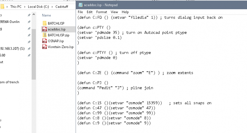

Cat3appr now that you have made your acaddoc.lsp you might like to add a few more common shortcuts. Sometimes the shortcut is just saving pressing enter in the steps. I am sure others will make suggestions for simple every day shortcuts.
(defun C:FD () (setvar "filedia" 1)) ; turns dialog input back on
(defun c:PTY ()
(setvar 'pdmode 35) ; turn on Autocad point ptype
(setvar 'pdsize 0.1)
(defun c:PTYY () ; turn off ptype
(setvar 'pdmode 0)
(defun C:ZE () (command "zoom" "E") ) ; zoom extents
(defun C:PJ ()
(command "Pedit" "J") ; pline join
(defun C:15 ()(setvar "osmode" 15359))   ; sets all snaps on
(defun C:47 ()(setvar "osmode" 47))
(defun C:99 ()(setvar "osmode" 99))
(defun C:8 ()(setvar "osmode" 8))
(defun C:9 ()(setvar "osmode" 9))

Just add to your acaddoc.lsp that is the idea it will load automatically every time.

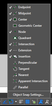

I can't find this acaddoc.lsp in my C , is it a file supposed to be somewhere ?  or do I have to create this acaddoc.lsp   if so where shall I put it ?  and what is the name to evoke it when I need to load the application ?    op
Please don't give anything for granted..
as it was suggested before in this tread ,   I have created  a folder C:\Cadstuff  where I placed a few lisps, and then under options I added this path in support file search path
However it's a curse, the osnaps keep on getting turned off each time i do a command....
I load the lisp attached, the osnap get turned on, then i executed a coomand, and they get turned off again....
Please help, but step by step, not just a copy&paste of a code, twithout further instructions , hanks you :)

Ok will try again, as you have a support directory c:\cadstuff take what I have posted previously paste into notepad and then saveas c:\cadstuff\acaddoc.lsp. Add this also. The other commands will work also.
(defun c:167 (setvar "osmode" 167))
At any time your osnaps are wrong just type 167 it should work.
ACADDOC.LSP
