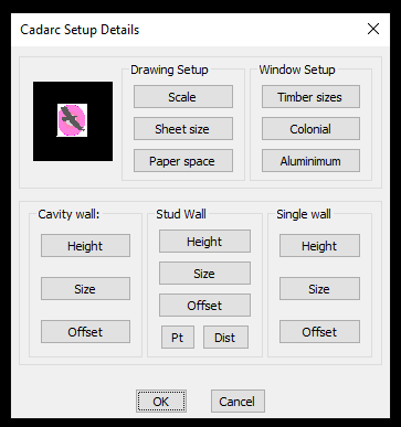

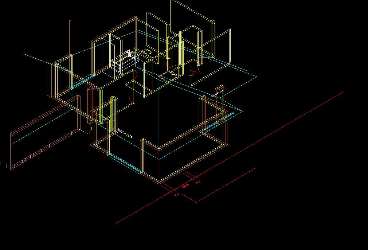

Drawing houses in 3d but its actually 2.5d and was written some 25 years ago it is available still and I am looking at revamping and updating, its not my software but I co-wrote a lot of it and have been given rights to sell. I would look at Briscad plus an add on like CADARC. There are others out there.
Huh, looks 3D to me.
I call it 2.5d as its not using solids, but standard Autocad objects no super smart objects. But yes you draw say a house then open up layouts and do views of all the elevations with "Hide" turned on. Like wise the roofs will appear solid or you can convert to lines. The window and door routines punch a hole through the walls, Revit say has smart windows you can move them, here you would erase and then add new window. The windows have a number of styles and there are sub dcl's for further details.

It has smart user layering behind it so user use always draws object on correct layer. Walls widths totally user definable as well as a reread so you can re measure existing walls saves entering widths. Has a simple floor plan rooms to walls routine.
Need to look at a non metric version.

Cadarc was developed over about 3 years with continuous development and has a brother package CT-Cadcivil.
Here is a simple 3d table as an example of using Autocad, Briscad, Intellicad etc. Or as Steven mentioned a excel spreadsheet for input.
