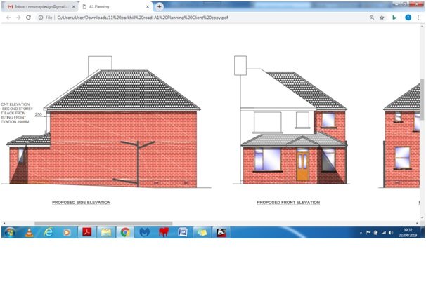

tat Posted April 22, 2019 Posted April 22, 2019 Hi All Does anyone know why these white lines appear when I email a pdf Thanks Tat Quote

tat Posted April 22, 2019 Author Posted April 22, 2019 Do you think the problem lays in when I email the drawing Quote

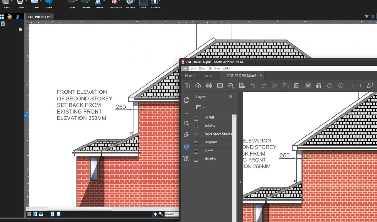

f700es Posted April 22, 2019 Posted April 22, 2019 Can you share the PDF? Your screen shot above shows you viewing the PDF through a browser. In my experience I have found this to be a not acceptable way to do it. Quote
rkmcswain Posted April 22, 2019 Posted April 22, 2019 @f700es - the PDF is included in the thread I linked to above. https://forums.autodesk.com/autodesk/attachments/autodesk/706/977035/1/PDF PROBELM.pdf Quote
f700es Posted April 22, 2019 Posted April 22, 2019 Yep, looks great on my end in Acrobat Pro and BlueBeam. As I said above the browsers don't seem to render the PDF files as well as the stand alone programs do. Quote
tat Posted April 22, 2019 Author Posted April 22, 2019 so its only a problem when I email the PDF? Quote
f700es Posted April 22, 2019 Posted April 22, 2019 In as much as the recipient is using their browser to view it and NOT a true PDF viewer. I have the same problem here (University). I'll email a PDF to someone and they get back with me that they can't zoom in enough or that the image quality is horrible. I ask them if they are using their browser to view the PDF? 99% of the time they are and it fixes the issues when I show them how to download it and then open it. 1 Quote
tat Posted April 30, 2019 Author Posted April 30, 2019 On 22/04/2019 at 20:22, f700es said: No problem, I hope you get it figured out You were right, it was viewing the drawing in a browser, that was the problem, thank you once again 1 Quote
