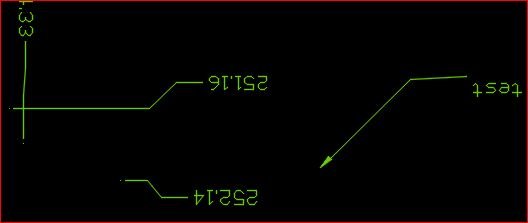

motee-z Posted April 18, 2019 Posted April 18, 2019 Hello in some drawing i am trying to show the text of the leader appear normal , but always it appears upside down also in dimordinate any idea of the reason Quote
rkmcswain Posted April 18, 2019 Posted April 18, 2019 Check to see if you are on WCS (World Coordinate System) Can't tell from your screenshot. Try a new, empty drawing also. Quote
CyberAngel Posted April 18, 2019 Posted April 18, 2019 Are these the old-style quick leaders or multi-leaders? Check the text style that is defined for the leader style, is that style an Upside-Down style? Have you tried to set the text style to "match text orientation to layout"? Quote
motee-z Posted April 18, 2019 Author Posted April 18, 2019 thanks friends i found the problem with your help it was because wcs system upside down thanks to rkmcwain and CyberAngel 1 Quote
