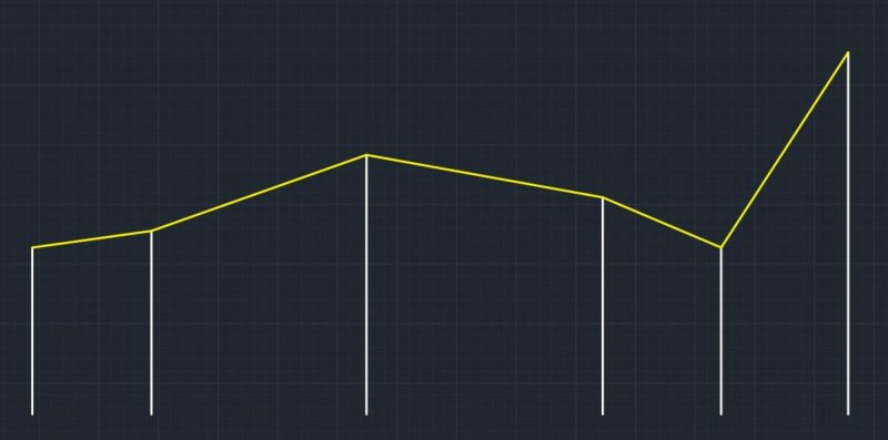

Connecting endpoints of vertical lines with polyline
Can somebody help me create lisp wich will create POLYLINE by connecting endpoints of vertical lines? (1 polyline with vertex on each endpoint of selected lines) Tnx

On 4/10/2019 at 2:39 AM, Lee Mac said:
Quick one:
(defun c:test ( / i l s x )
    (if (setq s (ssget '((0 . "LINE"))))
            (repeat (setq i (sslength s))
                (setq i (1- i)
                      x (entget (ssname s i))
                      l (cons (cons 10 (cdr (assoc (if (< (caddr (assoc 10 x)) (caddr (assoc 11 x))) 11 10) x))) l)
            (entmake
                (append
                    (list
                       '(000 . "LWPOLYLINE")
                       '(100 . "AcDbEntity")
                       '(100 . "AcDbPolyline")
                        (cons 90 (length l))
                       '(070 . 0)
                    (vl-sort l '(lambda ( a b ) (< (cadr a) (cadr b))))
Chooses line end point with greatest y-coordinate; assumes 2D & WCS.
HI GUYS
How we can modified it for doing this for pline ??

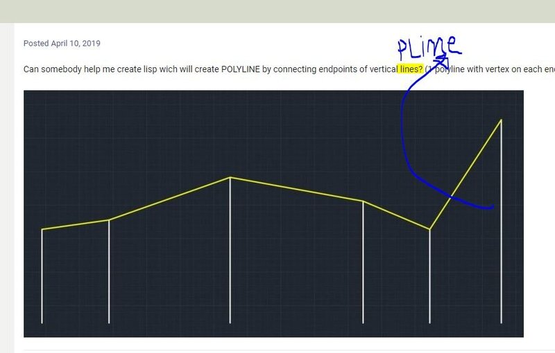

20 hours ago, hosyn said:
HI GUYS
Do you mean if the vertical lines are two-vertex 2D polylines?
No, just i want modify it for connect two endpoint of any pline indeed following :
Edited by hosyn
This is a totaly thing , my mean in this ::
