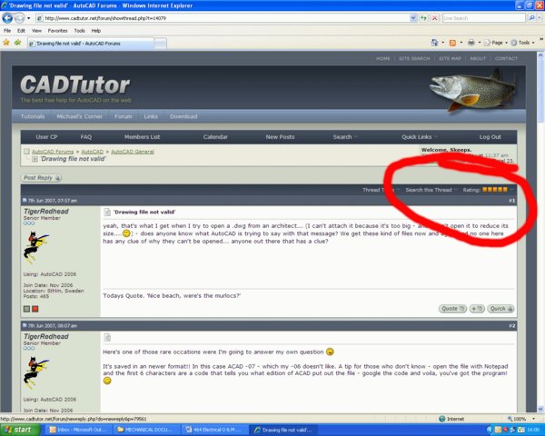

Skeeps Posted June 8, 2007 Posted June 8, 2007 funny I should happen upon this thread, I was just thinking about this very same problem. Thanks Tiger. I'm going to rate this thread. Quote
Guest Alan Cullen Posted June 8, 2007 Posted June 8, 2007 C'mon now Skeeps.....how do you rate a thread ??? It's not that I don't know.......just testing.... Okay....I don't know:( Suppose I want to add to that rating.....how do I do it..... PPLLEEAASSEE........you are the best......... (bloody wo-man) Quote
