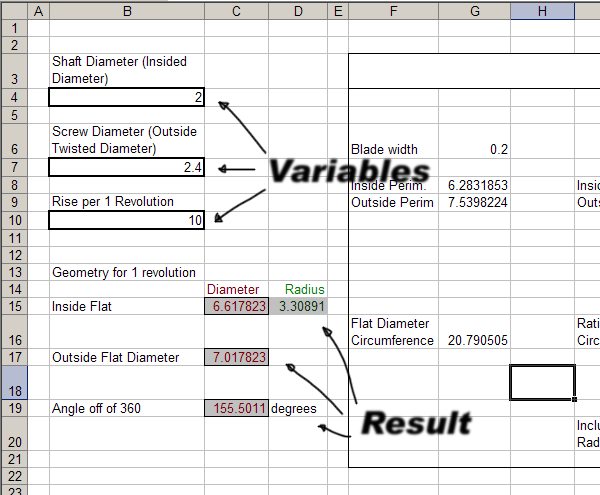

SEANT Posted January 23, 2009 Posted January 23, 2009 I may not have interpreted the problem correctly because I’m not exactly sure what the formula posted above is addressing. The problem was interesting (via my own interpretation anyway) so this is what I came up with. The Excel spreadsheet seems to jive with some flattened geometry produced with Rhino 3D. ScrewConveyorWorksheet.zipFetching info... Quote

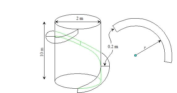

mdbdesign Posted January 26, 2009 Author Posted January 26, 2009 All data we got is: Stack height # of revolutions pitch of 1 revolution OD of stack We come up with this (previous post) solution but not yet checked in real life. I got no idea how I will check it before sent to laser cut (SS 316) How in your template I can input height? Quote

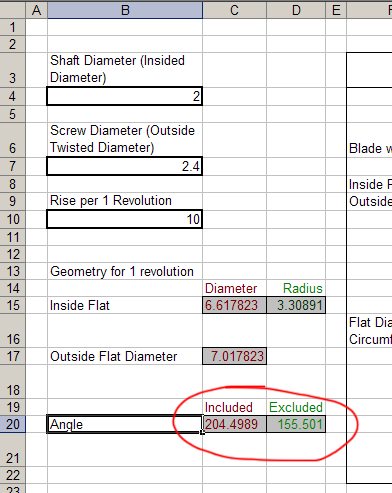

SEANT Posted January 27, 2009 Posted January 27, 2009 Based on your drawing, the variables in my spreadsheet should be Shaft Diameter – 2M Screw Diameter – 2.4M (2M + 0.2M + 0.2M) Rise per 1 Revolution – 10M That is I assume the blade is spanning the full height with one revolution. The new spreadsheet attached includes an additional readout for radius. The accompanying drawing illustrates the result and if you “List” the properties of the helix they match pretty well with the arc lengths. It would be kind of cool if Jochen could confirm the result with his method. Beyond that I can’t provide any further assurance. ScrwConvey2.zipFetching info... Quote
SEANT Posted January 27, 2009 Posted January 27, 2009 Clarification to spreadsheet. ScrewConvey.zipFetching info... Quote

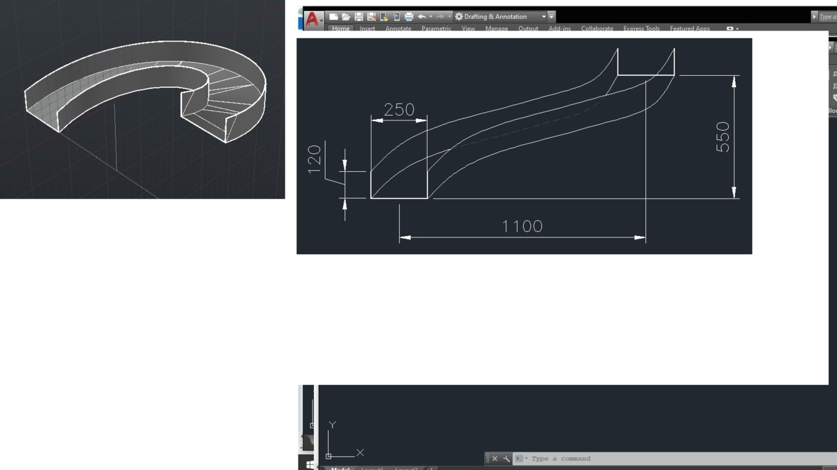

danny.tipantuna Posted December 2, 2020 Posted December 2, 2020 por favor pueden ayudarme con esto tomar en cuenta que el paso es de 1100 gracias Quote
