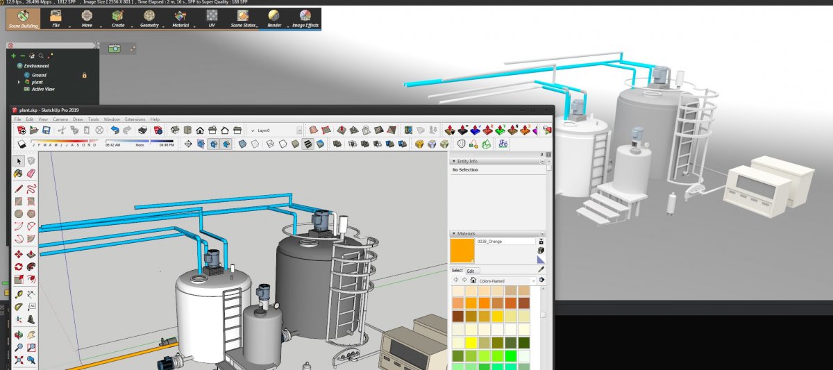

f700es Posted April 4, 2019 Posted April 4, 2019 Honestly it looks like an info-graphic and could have been made in Max, Maya, C4D etc. Edit: I took a look this morning and you could do this in SketchUp Make and SImlab Composer Lite (both free) in about a day. I looked in the 3D Warehouse for Chemical Plant and found a good start and rendered it up in SimLab (quick and dirty some colors need to be fixed) in 5 minutes.... Quote

f700es Posted April 4, 2019 Posted April 4, 2019 Yeah Inventor and Solidworks can make these models all day but as I said before this is an Infographic and I think they are OVER complicated for this image. Yeah those (Max, Maya and Blender) are all digital content creation software and not Mechanical CAD software. They are for movies, games and pretty pictures. All 3 are complex software and 2 of them are very expensive (Blender is free). I am pretty good at SU and knew that I could find some industrial models in the 3D warehouse to get me started on a test pretty quick. Quote
