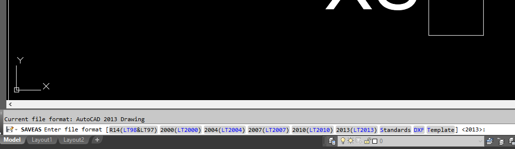

my autocad save / save as has misteriously changed, now the menu of the "save where" doesn't come down , i'm getting it all in the command bar, please how to revert to the normal way?
You can also press ~ on keyboard will force the dialouge open but filedia is better.
