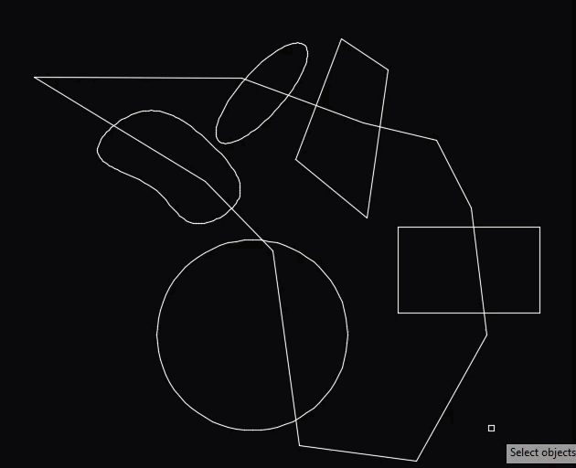

Shablab Posted April 2, 2019 Posted April 2, 2019 I have two polygons. One is my corridor (see white), and my other are disturbances (see red). I'm looking for a lisp that creates polygons everywhere where there is an overlap between the two (see green hatch). I currently have a lisp that gives me the area of the intersecting hatch but it is only a single use. I want to be able to click the white boundary layer and then the red intersecting layer and have it make intersecting polygons between those two. Quote

lrm Posted April 3, 2019 Posted April 3, 2019 Here's a simple process that does not use LISP but relies on the Booleans and regions. 1. Select all the objects and convert them to regions then select all the red regions and union them together. Note, to simplify the selection of the red regions just select all then type R (remove) and click on the white region. 2. Use the Boolean intersect on the two regions resulting in the shapes you want. 3. Use explode twice to get the outlines of the shapes. 1 Quote

ronjonp Posted April 3, 2019 Posted April 3, 2019 (edited) Based on code here this should do what you want: (defun c:foo (/ r o n s) ;; RJP » 2019-04-03 (cond ((and (setq s (ssget ":L" '((0 . "circle,ellipse,lwpolyline,spline")))) (setq s (vl-remove-if 'listp (mapcar 'cadr (ssnamex s)))) (setq s (vl-remove-if-not '(lambda (x) (vlax-curve-isclosed x)) s)) (setq n (vlax-ename->vla-object (cdr (assoc 330 (entget (car s)))))) (setq s (vl-sort (mapcar 'vlax-ename->vla-object s) '(lambda (a b) (> (vlax-curve-getarea a) (vlax-curve-getarea b))) ) ) ) (setq r (car (vlax-invoke n 'addregion (list (car s))))) (setq o (vlax-invoke n 'addregion (cdr s))) (mapcar (function (lambda (x) (vla-boolean (vla-copy r) acintersection x))) o) (mapcar 'vla-delete s) (vla-delete r) ) ) (princ) ) (vl-load-com) Edited April 4, 2019 by ronjonp updated code to include splines, ellipses, circles 1 Quote

BIGAL Posted April 4, 2019 Posted April 4, 2019 ronjonp If you have a circle does not do anything to it. Nicely done though circle may never exist. 1 Quote
ronjonp Posted April 4, 2019 Posted April 4, 2019 On 4/4/2019 at 2:58 AM, BIGAL said: ronjonp If you have a circle does not do anything to it. Nicely done though circle may never exist. Expand You are correct .. updated the code above to do a few more objects 1 Quote
