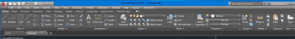

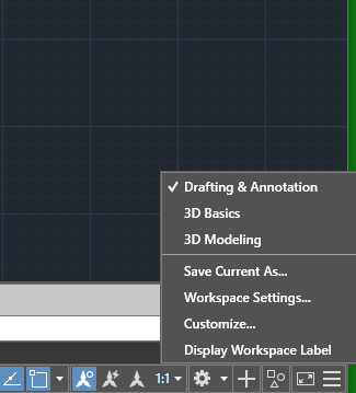

How can I get the 2d drafting settings on autocad 2019 3D?   I find the layout rather confusing.
And in the workspace switching there's no 2d drafting or map classic....
help anyone? :)
I can't believe it there is not a way to load the workspace of 2D drafting?!

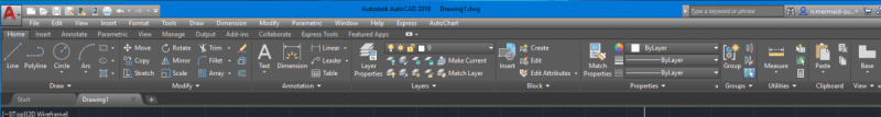

Run the -TOOLBAR command with the “-” symbol, this is extremely important!
    Enter the name of the panel, for example, Standard (Standart) or Draw (Draw)
    Select the option Show (Shaw).
    The coveted panel appears in the workspace.
    Hiding the ribbon with the RIBBONCLOSE team
    Enable the drop-down menu by setting the value of the variable MENUBAR equal to 1 (0 - disabled)
    Right-click on the panel and turn on all the other necessary panels.
    For full compliance with the classic interface, you need to open the Standard (Standard), Styles (Styles), Layers (Layers), Properties (Properties), Draw (Edit), Modify, Workspaces (Worspaces).
    We arrange the panels on the working field (the panel bindings work!)
    Save the current workspace under the name, for example Classic interface
    Enjoy!
