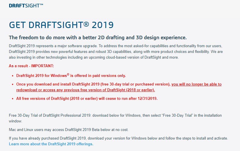

f700es Posted April 2, 2019 Share Posted April 2, 2019 Have you seen this update? https://www.3ds.com/products-services/draftsight-cad-software/download-draftsight/ Quote Link to comment Share on other sites More sharing options...
Quik&Easy Posted April 3, 2019 Author Share Posted April 3, 2019 Thanks for posting that; I have not seen that. With that information and having to buy it, I'll have to decide whether to stick with it and pay or move to Bricscad and pay. Decisions, decisions............ Quote Link to comment Share on other sites More sharing options...
f700es Posted April 3, 2019 Share Posted April 3, 2019 Well I'd certainly try the DraftSight 2019 demo and see if it works for you. $99 to $199/yr is not too bad to deal with. It says only the Windows version so....maybe install Ubuntu under a VM and continue to use it there? I have a spare box at work that I might but Ubuntu on and try it. Quote Link to comment Share on other sites More sharing options...
