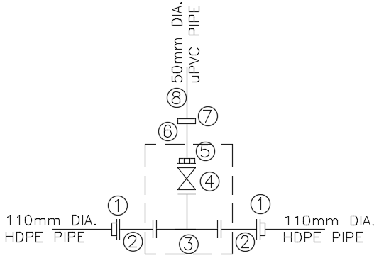

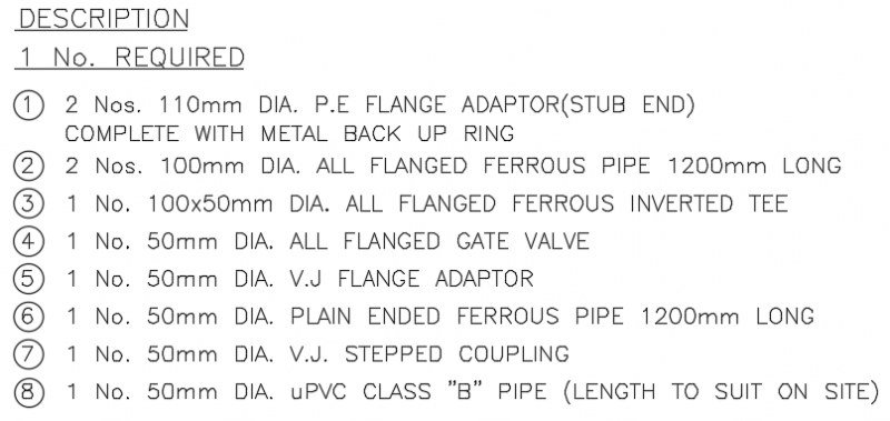

I intentionally left it open. Because from the Google searches I haven't found anything that covers connections. Therefore I thought I should simply try and see what is available first. Whether for Water, Sewers or gas to whatever Standard. The point is if there is one that covers any of the applications under whatever Standard, I can always modify it to suit my particular need. Basically what I need is more or less a template to work on and adjust accordingly. For your information this is what am trying to define
The fittings required will obviously vary depending on the size and material of the pipes connecting. So was hopping for a lisp that you can select the Pipe Diameter and Material, then it outputs the sketch and required fittings from a predefined Database/ Options.
Edited by Alcapone001
This is what was needed. Some one should be able to help it looks like a library of blocks.

I think essentially one can define the blocks, then based on the pipe material and size chosen, the relevant block is brought up...
