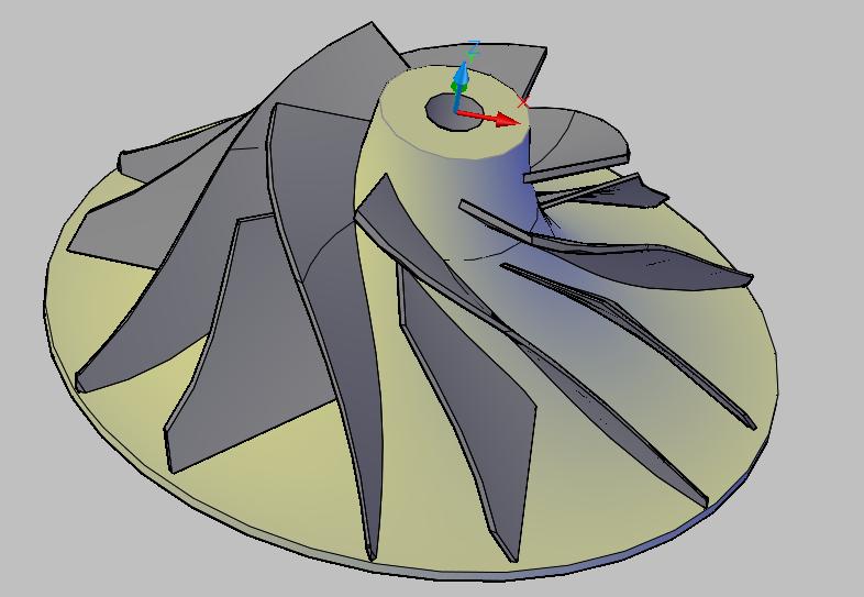

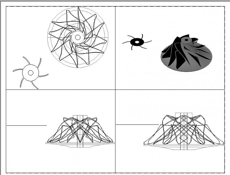

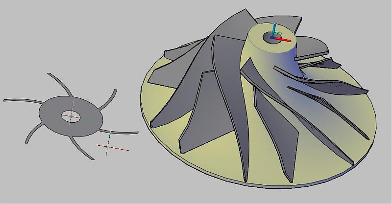

shift1313 Posted January 23, 2009 Posted January 23, 2009 here is something i sectioned. you can see the ucs at the top. i selected my object. typed XY to use the xy plane and entered a coordinate of 0,0,-1. The first picture has already been sectioned. in the second pic i moved the 2d region i got from the section off to the side so you can see it. Since you are selecting edges it may not be apparent that you have a 2d region. Maybe you should just go into layout and create a layout of your drawing in 2d wireframe mode. It sounds like this might be what you are looking for. the 3rd pic is a layout using 2d wireframe for the top and side views, and a "realistic" setting for the iso view. Quote
