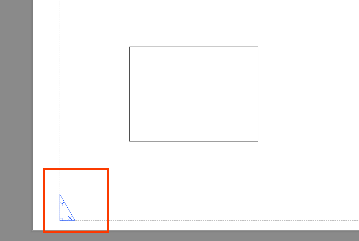

Thanks @ronjonp,
When I run that EXAMPLE_UCSICONATORIGIN I get an ERROR.
  Quote
error: Automation Error. No active viewport in paperspace
Expand
Also, I did pop by that other thread but never got it to work.
Maybe it's connected to the error I'm getting.
I've attached a file that I'm testing on where the UCS is not at 0,0.

Think you're referring to the Viewports in the layout tabs.
It's the layout tab UCS I'm referring to.
See attached.
