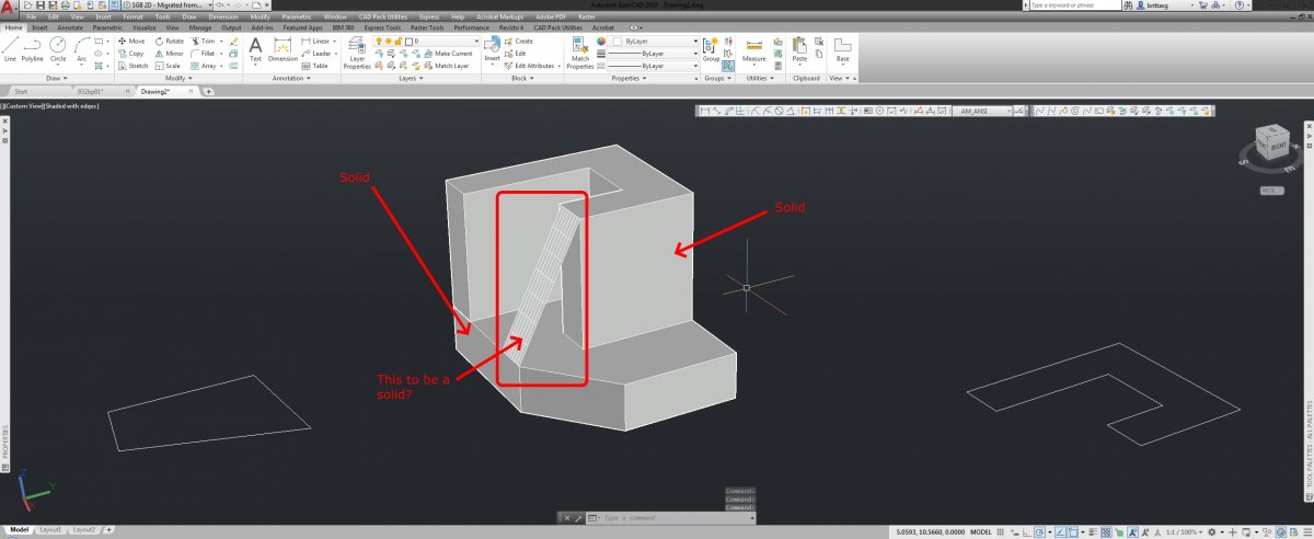

SMRITI Posted March 21, 2019 Posted March 21, 2019 (edited) i want to change my mesh to solid mesh using extrude and presspull but i am getting wired one . how to change that? Drawing2.dwg Edited March 21, 2019 by SMRITI Quote
f700es Posted March 21, 2019 Posted March 21, 2019 Are you wanting the sloped face to be a solid on the top part? Quote
ReMark Posted March 21, 2019 Posted March 21, 2019 (edited) It would probably take less than 10 seconds to recreate the missing section of the object as a solid by extruding a polyline triangle. Edited March 21, 2019 by ReMark 1 Quote
f700es Posted March 21, 2019 Posted March 21, 2019 What I was thinking as well Remark. I know new users have trouble with what we see as easy answers. You have the 3 points for the triangle. Extrude and then union all the solids - Done! Quote
