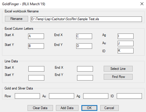

rlx Posted March 24, 2019 Share Posted March 24, 2019 (edited) 1 hour ago, ktbjx said: I added the code you gave, i dives to another error lol error: no function definition: VOID OMG! is she okay??! I hope she's fine forget about us for a bit, take care of her!! hope I haven't forgot any more (defun void (x) (or (null x) (and (eq 'STR (type x)) (eq "" (vl-string-trim " \t\r\n" x))))) both my parents are still alive but at an age where every new day is bonus but you know the inevitable will happen , sooner or later... made a second version for the dialog (in case anybody gives a ) attached updated version of lsp (with void and dcl subs) if anythings missing , let me know... RLX GoldFinger.LSP Edited March 24, 2019 by rlx Quote Link to comment Share on other sites More sharing options...
ScoRm Posted March 24, 2019 Author Share Posted March 24, 2019 5 hours ago, rlx said: hope I haven't forgot any more (defun void (x) (or (null x) (and (eq 'STR (type x)) (eq "" (vl-string-trim " \t\r\n" x))))) both my parents are still alive but at an age where every new day is bonus but you know the inevitable will happen , sooner or later... made a second version for the dialog (in case anybody gives a ) attached updated version of lsp (with void and dcl subs) if anythings missing , let me know... RLX GoldFinger.LSP 26.21 kB · 1 download I just got here at work, i am excited to try this right away! by the look of it, its more than i asked for. I am so thankful for you! thank you so much! And I know the feeling, I still have my grandfather with me who practically raised me. Take Care of them, you'll never know how much you missed someone until they're out of your life Quote Link to comment Share on other sites More sharing options...
BIGAL Posted March 24, 2019 Share Posted March 24, 2019 Nice dialogue. Quote Link to comment Share on other sites More sharing options...
rlx Posted March 24, 2019 Share Posted March 24, 2019 4 minutes ago, ScoRm said: I just got here at work, i am excited to try this right away! by the look of it, its more than i asked for. I am so thankful for you! thank you so much! And I know the feeling, I still have my grandfather with me who practically raised me. Take Care of them, you'll never know how much you missed someone until they're out of your life Here in NL its just after midnight so while you are going to work I'll be soon be going to bed. Have also included a version with all coordinates concatenated , see if it works better / faster. Only way to find out is testing it on the real deal... While knowing what the future will bring , I still hope my parents will live forever but sadly that's not how it works... Goodluck with your project golddigger , euh goldfinger if you have any problems or questions let me know. think I'm gonna cash in on some of my overtime hours tomorrow gr. RLX GoldFinger.LSP 1 Quote Link to comment Share on other sites More sharing options...
rlx Posted March 24, 2019 Share Posted March 24, 2019 (edited) 37 minutes ago, BIGAL said: Nice dialogue. Thanks BIGAL , think most of my time went to the interface. It allways bugs me when I see something that doesn't look or feel how I want it. Well, lights out for me... gr. RLX Edited March 24, 2019 by rlx Quote Link to comment Share on other sites More sharing options...
ScoRm Posted March 25, 2019 Author Share Posted March 25, 2019 (edited) Update: It Runs Smoothly!, I used the Version2 (ktbjx's Suggestion), He does have a point, the version1 is good when i have 10K or 20K lines only, because it has a small chance of getting the same SUM with 2 totally different lines. But it's bound to happen when we're talking about 100K above. ktbjx's suggestion was to concatenate all 4 values into 1 so it will be a unique string... But both seems to run fast! well, im testing it on 50K here and its fast! Just a thought, Can it be done without the excel window showing? Its kinda redundant seeing the data in the dialog(which is the only thing i need) and having the excel window showing too in the background. I have this impulse to click it and see if the data is there, then i know that it is there lol! Edited March 25, 2019 by ScoRm Quote Link to comment Share on other sites More sharing options...
rlx Posted March 25, 2019 Share Posted March 25, 2019 8 hours ago, ScoRm said: Update: It Runs Smoothly!, I used the Version2 (ktbjx's Suggestion), He does have a point, the version1 is good when i have 10K or 20K lines only, because it has a small chance of getting the same SUM with 2 totally different lines. But it's bound to happen when we're talking about 100K above. ktbjx's suggestion was to concatenate all 4 values into 1 so it will be a unique string... But both seems to run fast! well, im testing it on 50K here and its fast! Just a thought, Can it be done without the excel window showing? Its kinda redundant seeing the data in the dialog(which is the only thing i need) and having the excel window showing too in the background. I have this impulse to click it and see if the data is there, then i know that it is there lol! in the lisp file on line 354 you can change (vla-put-visible *excel-app* :vlax-true) -> (vla-put-visible *excel-app* :vlax-false) could make a toggle so user can select this behavier. Button 'Find Row' lets user select a row in the xls file and show the data in goldfinder dialog so here excel obviously should be visible. Quote Link to comment Share on other sites More sharing options...
rlx Posted March 25, 2019 Share Posted March 25, 2019 (edited) I couldn't resist... GoldFinger.LSP Edited March 25, 2019 by rlx 2 Quote Link to comment Share on other sites More sharing options...

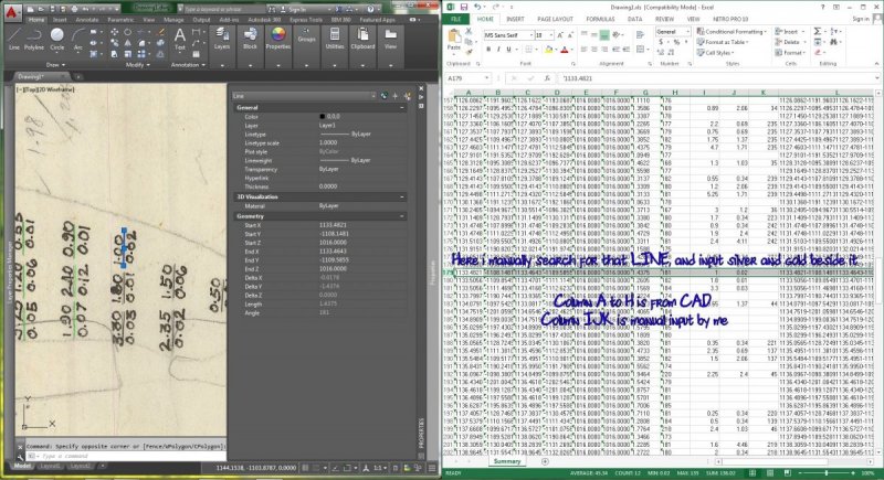

rlx Posted March 26, 2019 Share Posted March 26, 2019 It looked like a nice challenge to make and after I saw what OP had to do for his work , I thought , gee , I don't know what this guy did wrong , but his boss must really hate him for having him check every point manually haha. So I decided to try to make OP's life a little less miserable Quote Link to comment Share on other sites More sharing options...
