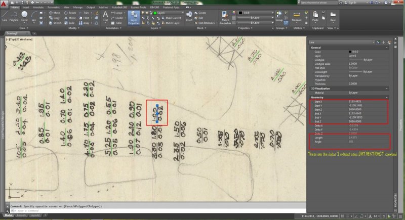

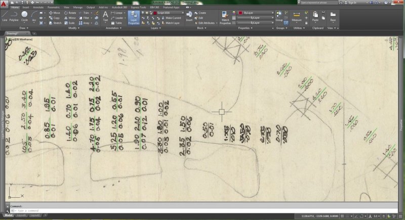

ScoRm Posted March 18, 2019 Share Posted March 18, 2019 (edited) I am so sorry for asking, but I am desperate to find a faster way. is it even possible to have lots of LINES (Dataextract in cad) and some lisp to manually search those extracted lines, and when it sees that LINE in excel, u have manual input of values to save beside the searched line? ok, its like this... this drawing files have lines all over, and those lines represents sample cuts, those sample cuts have values (usually gold and silver). now i need to dataextract those lines to put the coordinates in excel format so that we can put the sample cuts values (gold or silver)... my problem is, its so much time consuming to manually search for a line, and then putting the golds or silver (is found) with so much LINES all over. So I was thinking maybe I could ask for help. so that the lisp routine can search for the line i want, and put the values i need. again, I am so sorry for asking... Edited March 18, 2019 by ScoRm Quote Link to comment Share on other sites More sharing options...
BIGAL Posted March 20, 2019 Share Posted March 20, 2019 So how do you know now what is a gold and silver line ? Is it to do with length orientation some sort of key to be searched on. Quote Link to comment Share on other sites More sharing options...
ScoRm Posted March 20, 2019 Author Share Posted March 20, 2019 6 hours ago, BIGAL said: So how do you know now what is a gold and silver line ? Is it to do with length orientation some sort of key to be searched on. no, no key... manually i am looking at their start points and endpoints(im searching for the line coordinate, not a key) and to answer the first question... those lines are sample cuts and when they get samples, they test it for everything. meaning that line has various data in it. i only specify silver and gold. so every single line i need to search will have silver and gold that i will manually input... i need to visually check it, for me to assign weather those lines will be as single(wall samples) or as composite (face samples) lines. that is why we use autocad to draw lines and "Dataextract" it to excel file. Im wondering if autolisp could access excel, so in that case autolisp can get the startpoints and endpoints of a line being selected in autocad, and searching those coordinates in excel file "dataextracted" from that cad. and if the line is searched, autocad will prompt me for values to input (that will be the silvers and golds). and save it beside the row where the line is in... Quote Link to comment Share on other sites More sharing options...

ScoRm Posted March 21, 2019 Author Share Posted March 21, 2019 (edited) 7 hours ago, BIGAL said: Still totally confused may have to walk away. I understand... thank you for trying though. basically the lines if you use dataextract command, it will give you XYZ's lengths and angles of a line right? all i need is for a lisp to search where the coordinate extracted is... dont bother about the silvers and golds, because that is my part, that is where i need to input. This is what the lines looks like (the ones i will export into excel) if i select a line, it will give show me the XYZ's of that line right? I need to find that or search that in the excel extracted. for me to input the silvers and golds manually it looks like this.(this is what i do and its time consuming) that is why i ask for help to automate searching and inputing... Edited March 21, 2019 by ScoRm Quote Link to comment Share on other sites More sharing options...
rlx Posted March 21, 2019 Share Posted March 21, 2019 your pic's are not showing. But basically you want to find the row number in excel that contains a specific x y z? Quote Link to comment Share on other sites More sharing options...
ScoRm Posted March 21, 2019 Author Share Posted March 21, 2019 (edited) 4 hours ago, rlx said: your pic's are not showing. But basically you want to find the row number in excel that contains a specific x y z? YES! but more than that sir, i need do input the silver and gold values too beside it... So on the Row that contains the specific X Y Z, i will add gold and silver too. Thats it! because it is kind of hard when the lines are too much, it is very time consuming i will try to edit the pictures... Edited March 21, 2019 by ScoRm Quote Link to comment Share on other sites More sharing options...

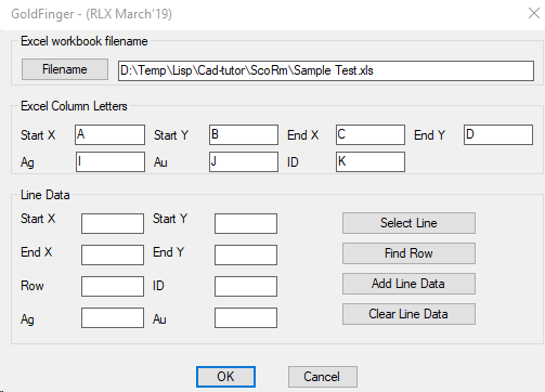

rlx Posted March 23, 2019 Share Posted March 23, 2019 (edited) ok, I'll post what I've made so far. Program is not yet finished, just to give you a preview. Think I will make a small change to the dialog for better workflow. Things I want to know , are the start and end coordinates allways adjacent (column a b c d) or did you make it so just for the test? Its not really a big deal , its just for me how to read te cell values from excel , in one go (for example range A3:D3) or like for seperate cell adresses like A1 , B1 , K1, L1 whatever. Like I said it's no big deal , just for speed its simpeler to read 1 range than 2x2 or 4x1 if you understand what I mean. In the version I've made so far it opens the excel file you select with button 'filename' , it reads the values from the column letters specified in the next part of the dialog. I have given them the default from your xls example A-D. Now for the 'tricky' part. Your example is rather small but you mentioned 10 or 20k lines... that's a lot of excel rows. In order to speed things up I came up with the folowing idea (and I don't know if it will always work) : I read the 4 coordinates (which are stored as a string in your xls file) , I convert them back to a number and sum them to a single number. So now , if you have 20k of lines in your drawing , I build an index list of 20k (single) numbers. Else I would either build a list of 4 strings times 20k... you do the math. Or for every line search I would have to start at the first data row in excel and read every line untill I hit gold (or silver)....just some inside info into my brain... Ok , when you have started goldfinger , xls will be opened automatically , index will be build. If xls is big this may or may not take some time. But when index has been build , assuming you are in the drawing with the hidden treasures , you can click button 'Select Line' and select a line (amazing no?). It will then do the same as it did with the index , sum all coordinates to a single nummer and then try to find it in the index. If it does , you'll know! It doesn't add any data yet , just want to know if my approach is working or not. RLX GoldFinger.LSP Edited March 23, 2019 by rlx Quote Link to comment Share on other sites More sharing options...
ktbjx Posted March 24, 2019 Share Posted March 24, 2019 (edited) 21 hours ago, rlx said: ok, I'll post what I've made so far. Program is not yet finished, just to give you a preview. Think I will make a small change to the dialog for better workflow. Things I want to know , are the start and end coordinates allways adjacent (column a b c d) or did you make it so just for the test? Its not really a big deal , its just for me how to read te cell values from excel , in one go (for example range A3:D3) or like for seperate cell adresses like A1 , B1 , K1, L1 whatever. Like I said it's no big deal , just for speed its simpeler to read 1 range than 2x2 or 4x1 if you understand what I mean. In the version I've made so far it opens the excel file you select with button 'filename' , it reads the values from the column letters specified in the next part of the dialog. I have given them the default from your xls example A-D. Now for the 'tricky' part. Your example is rather small but you mentioned 10 or 20k lines... that's a lot of excel rows. In order to speed things up I came up with the folowing idea (and I don't know if it will always work) : I read the 4 coordinates (which are stored as a string in your xls file) , I convert them back to a number and sum them to a single number. So now , if you have 20k of lines in your drawing , I build an index list of 20k (single) numbers. Else I would either build a list of 4 strings times 20k... you do the math. Or for every line search I would have to start at the first data row in excel and read every line untill I hit gold (or silver)....just some inside info into my brain... Ok , when you have started goldfinger , xls will be opened automatically , index will be build. If xls is big this may or may not take some time. But when index has been build , assuming you are in the drawing with the hidden treasures , you can click button 'Select Line' and select a line (amazing no?). It will then do the same as it did with the index , sum all coordinates to a single nummer and then try to find it in the index. If it does , you'll know! It doesn't add any data yet , just want to know if my approach is working or not. RLX GoldFinger.LSP 17.71 kB · 2 downloads OMG I am so excited to try this first thing in the morning! Thank you so much for helping me. and your question above, about coordinated in ABCD... yes it is always like that StartX StartY EndX EndY StartZ EndZ Length Angle For the Searching, Just a Thought. What if you concatenate all StartX StartY EndX EndY so you will have a unique single ID, my concern is, what if 2 totally different coordinates sums up with the same number? you are so amazing! Edited March 24, 2019 by ktbjx 1 Quote Link to comment Share on other sites More sharing options...
rlx Posted March 24, 2019 Share Posted March 24, 2019 well , the theory is (my still to be proven theory) that with four digits accuracy the sum of the digits will create a unique number (checksum). Of course I can make index algorithm selectable with a toggle so in case it does fail you can use the golden canon instead of the golden gun . I have the routine fully functioning now , including writing the data. Only considering a minor change to the dialog design and put the fields that need to be written to the excel file (Au , Ag & ID) in a seperate boxed row. Quote Link to comment Share on other sites More sharing options...
rlx Posted March 24, 2019 Share Posted March 24, 2019 here is the latest version so far. You can test it with example drawing & xls file posted earlier by OP . GoldFinger.LSP Quote Link to comment Share on other sites More sharing options...

ktbjx Posted March 24, 2019 Share Posted March 24, 2019 1 hour ago, rlx said: here is the latest version so far. You can test it with example drawing & xls file posted earlier by OP . GoldFinger.LSP 22.56 kB · 1 download error: no function definition: SAVE_DIALOG_DATA the GUI opens and close Quote Link to comment Share on other sites More sharing options...
rlx Posted March 24, 2019 Share Posted March 24, 2019 (edited) 6 hours ago, ktbjx said: error: no function definition: SAVE_DIALOG_DATA the GUI opens and close sorry , just had a major medical emergency at my parents house (something wrong with my mother) and I am just back from hospital (situation is stable for now). probably routine is missing the following (defun Save_Dialog_Data (%tl) (mapcar '(lambda (x) (eval (car x))) %tl)) (defun Reset_Dialog_Data (%tl %rd) (mapcar '(lambda (x y) (set (car x) y)) %tl %rd)) (defun Set_Dialog_Tiles (%tl) (mapcar '(lambda (x / v) (if (eq 'str (type (setq v (eval (car x))))) (set_tile (cadr x) v))) %tl)) hadn't noticed this because I have more routines that use these functions so they are always loaded one way or the other. RLX Edited March 24, 2019 by rlx Quote Link to comment Share on other sites More sharing options...
