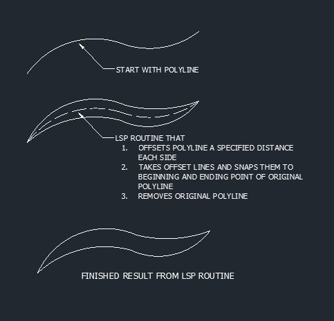

I am working on a project that a lsp routine would help a lot.  The problem is I don't know if it is even possible. I assume it is, but don't know.  Thought someone here with more knowledge would be able to tell me if it is.  I have several polylines that need to be offset a variable I enter for an offset and then snapped back to the beginning and ending of that polyline that it is offset to.  I know crazy.  I attached an image to illustrate what i am talking about. Let me know your thoughts.
Thanks!

Hi,

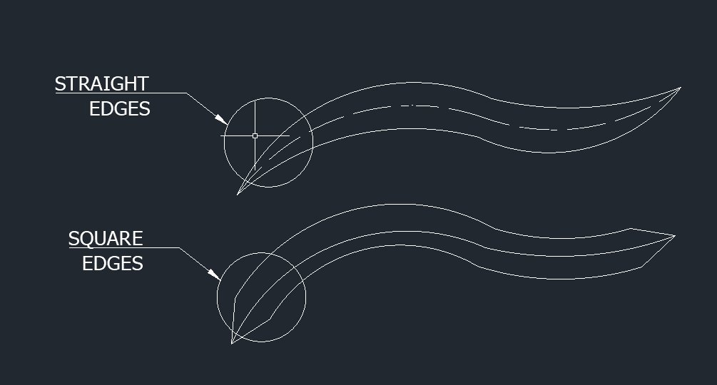

Please forgive my ignorance on this because anything I ask is from my lack of knowledge in the area of lisps.  Is there a command I can type in to use the “pline offset with taper ends.lps”, right now I am having to load it each time to use it?  Is there a way to be able to window and pick multiple lines at one time?  And lastly is there a way for it to be a smooth and straight from the start and end lines like I have in my attached picture?   It may not be possible.  I just thought I would ask.  I do really appreciate everybody’s time and help.  Thank you! 😃

Few quick answers:
You can autoload lisp programs, so you don't have to do it manually everytime. (ironically while working half of the lisps I use, I'm loading manually)
Yes, I'd call it an 'easy' modification.
Its possible, but I don't have that much free time to play with:
From each endpoint of the original polyline, find the vector that is tangent to the offseted polyline, resulting in finding the intersection point from where the straight taper would start.
Although looking at the picture the above algorithm may not produce the desired result, because a curve/bulge is used for the taper.
Another easier approach would be to use Lee's Polyline Taper and Polyline Outline, so you could manipulate each start/end segment's width for every polyline and in the end outline them.
And I believe that would produce the desired result.
You won't be able to achieve the desired result purely through manipulation of an offset polyline, as the required object is elliptic and polylines do not support elliptic segments, the closest would be an approximation using multiple linear or arc segments.
Note that my Polyline Outline as suggested by others in this thread is also an approximation, with the result for a varying width arc segment obtained through the construction of an ellipse from 5 points calculated on the polyline outline boundary.
Edited by Lee Mac

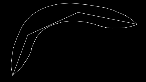

I tried pedit  spline and fit to the version I did to the outside plines created they smooth but the ends are not super smooth.
I had another go at it and rather than 1 pline I made 2 left and right the used pedit F ended up with this. I have to redo the code.
MoeJoe  try manually explode the pline and rejoin one side at a time then pedit. If thats what you want I am sure you will get 2 or 3 answers.
