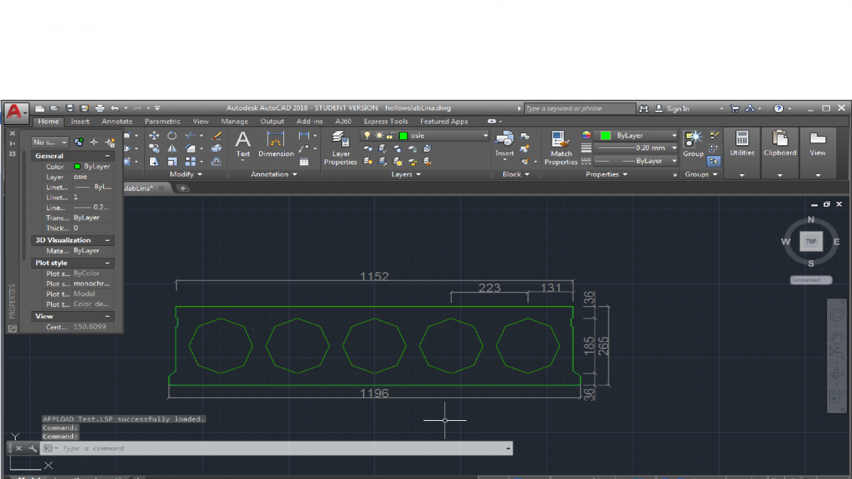

paulina.styrczula Posted March 12, 2019 Posted March 12, 2019 (edited) Hello, i was searching all day a way to determinig the section modulus of the hollow core slab statical moment. I'm now angry and devastated cause i spent the whole day for founding the solution. Now i've found your autocalisp on the forum -> but dont understand how to use it in reality.i'm attaching my file in the autocad in case you would like to help me. my the whole group of students dunno how to manage so i will help them to ..if you do hollow Lina.dwgFetching info... Edited March 12, 2019 by paulina.styrczula Quote
paulina.styrczula Posted March 12, 2019 Author Posted March 12, 2019 hollow Lina.dwgFetching info... Quote

paulina.styrczula Posted March 14, 2019 Author Posted March 14, 2019 but there isnt any reference to the section of modulus (first moment of inertia or statical moment). i am attaching the file without any structural complications ( just the section of which i want to obtain the section of modulus) hollowslabLina.dwgFetching info... Quote

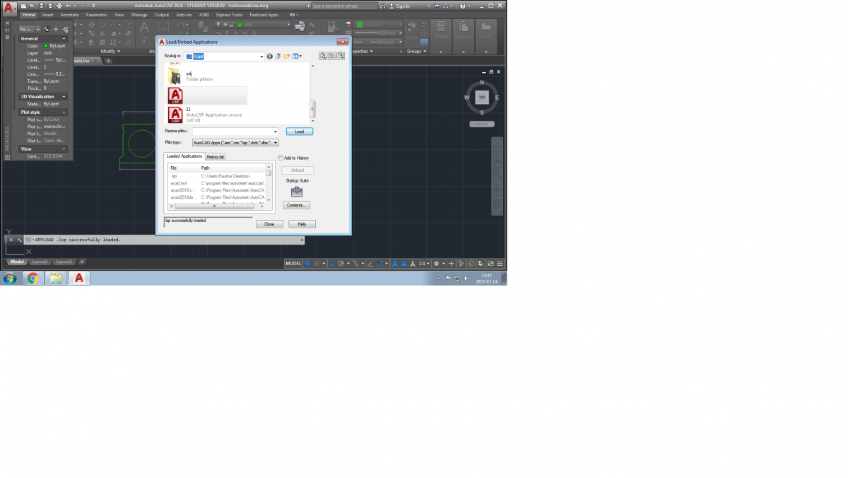

paulina.styrczula Posted March 14, 2019 Author Posted March 14, 2019 Everything seems to be clear. but i have an error, just after clicking on the 'load' and then on 'close' Quote

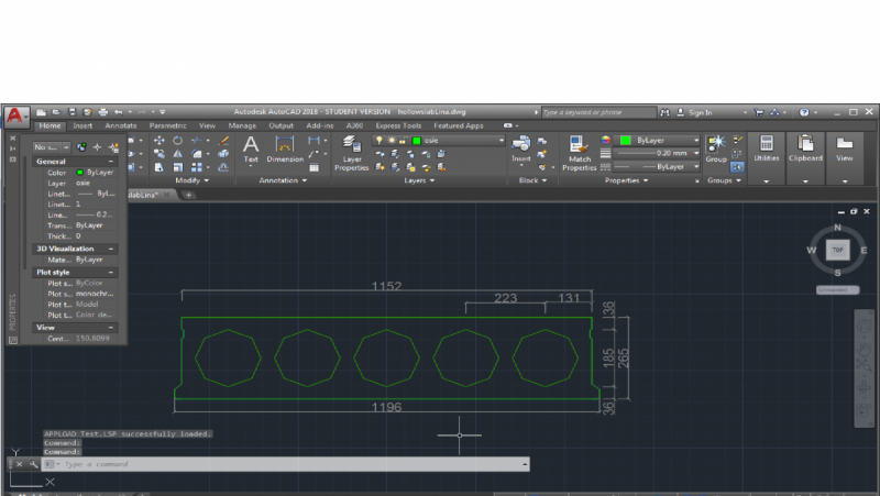

Tharwat Posted March 14, 2019 Posted March 14, 2019 It seems that you could not create the file correctly so please use the one in the attachments down here. Test.LSPFetching info... Quote
paulina.styrczula Posted March 14, 2019 Author Posted March 14, 2019 alright, ive used your file.But still nothing shows up.But there's a development-no errors. Quote
Tharwat Posted March 14, 2019 Posted March 14, 2019 Now you need to call the command TEST then select the region object. Quote
paulina.styrczula Posted March 14, 2019 Author Posted March 14, 2019 (edited) omg i have it !!! Does this moment of inertia show up in tghe cpommand line? Edited March 14, 2019 by paulina.styrczula Quote

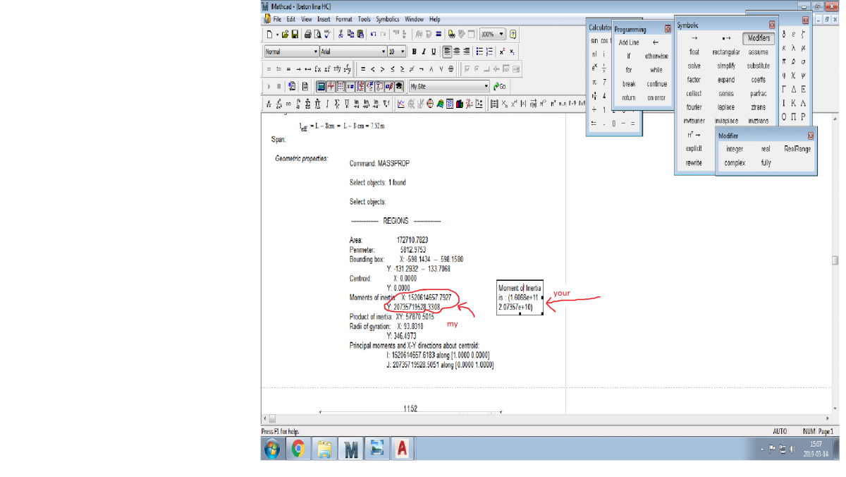

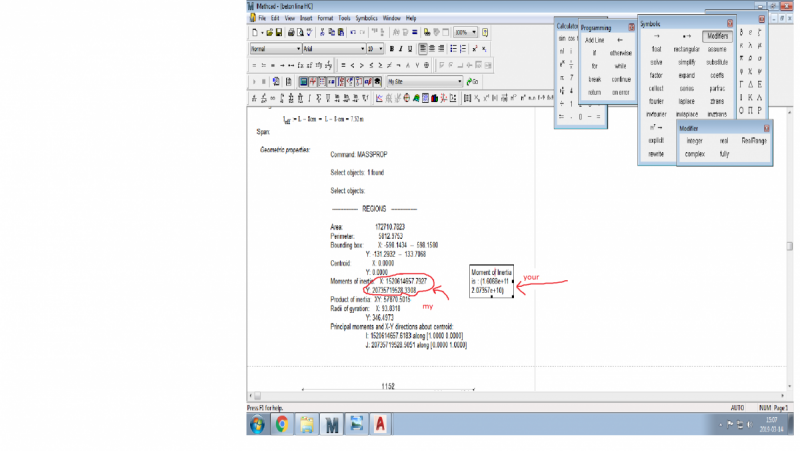

paulina.styrczula Posted March 14, 2019 Author Posted March 14, 2019 Thank you one more time. But are you sure it is modulus of section? usually second moment of inertia is mentioned in the autocad as moemnt of inertia. but after thorougly look on the units i can say that this is section modulus.. Second question: can i use this lsp file to all of the sections?i have also TT section to determine Quote
paulina.styrczula Posted March 14, 2019 Author Posted March 14, 2019 Thank you one more time. But are you sure it is modulus of section? usually second moment of inertia is mentioned in the autocad as moemnt of inertia. but after thorougly look on the units i can say that this is section modulus.. Second question: can i use this lsp file to all of the sections?i have also TT section to determine EDIT: unfortunately it isnt sectoin modulus. Ive compared 'your' scores with my .It the same. whta i need is'section modulus..' Quote
paulina.styrczula Posted March 14, 2019 Author Posted March 14, 2019 the results are very similar. it is not what i wanted :(( Quote
lrm Posted March 14, 2019 Posted March 14, 2019 Tharwart's program outputs the Moment of Inertia about the x and y axis through the centroid. This yields the same value as provided by the massprop command. I think you want the Principal Moment which is also provided by the massprop command. I did a hand calculation assuming a rectangle (b*h^2)/6 and five round holes (pi *d^3)/32 and got a similar result to the massprop Principal Moment value. Try it out yourself. Quote

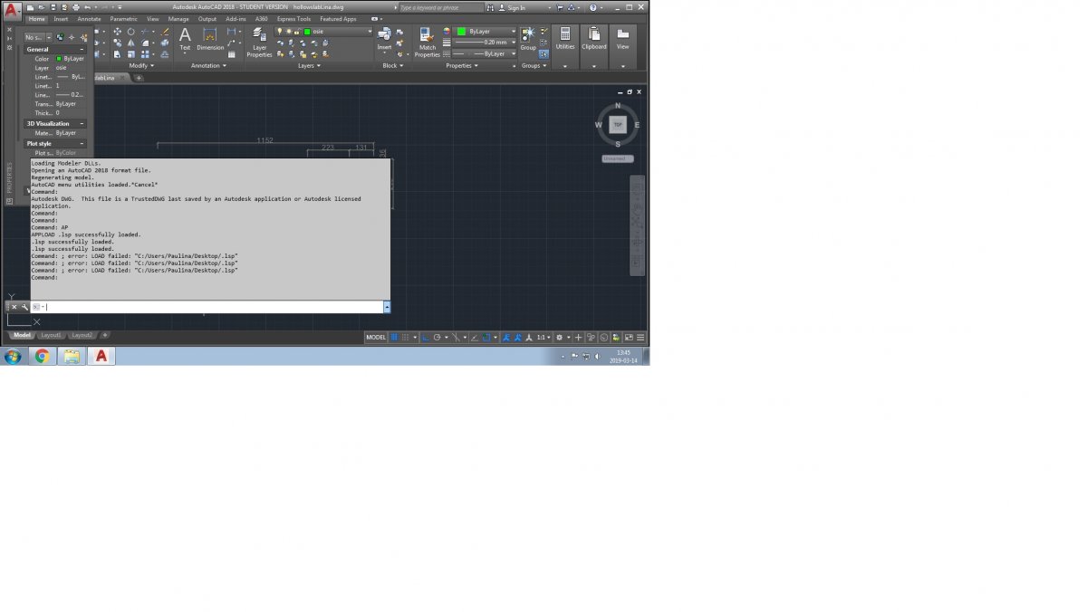

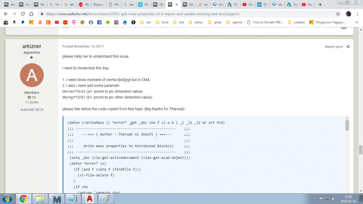

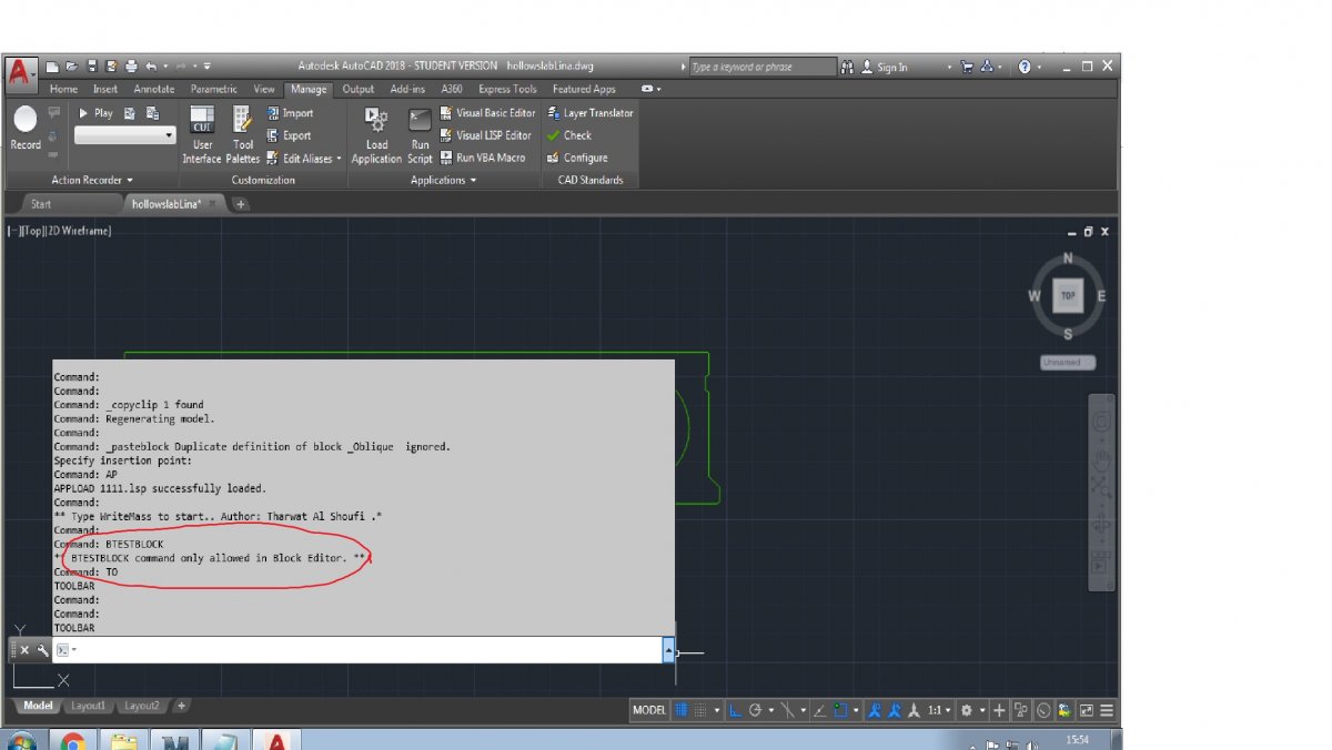

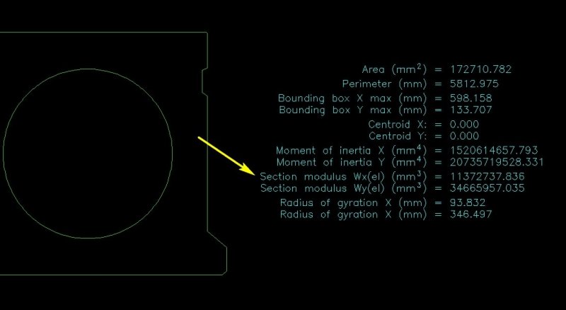

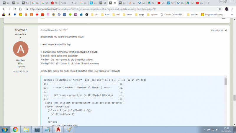

paulina.styrczula Posted March 14, 2019 Author Posted March 14, 2019 its once again me. i know now how to paste file without error:) it was my fault. so now ive found ths like this on thje forum , but sth like in the screen appears.So now ive stucked in one place again Quote

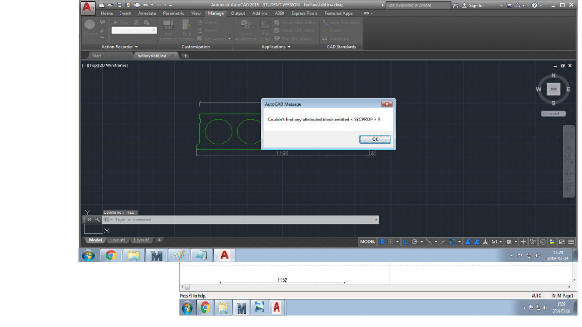

paulina.styrczula Posted March 14, 2019 Author Posted March 14, 2019 also ive tried the second method as presented here. but the message appears as below.. Quote
