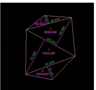

harshad Posted March 8, 2019 Posted March 8, 2019 hi i am looking for some large calculation stuff. lisp To read area of selected polyline, triangles ,rectangle, circle and other shapes with details of calculation. lisp will give Area of an entity with single command. which will give detailed table of calculation for all the selected shape , But how does it calculate the area e.g. (base and height of the triangle and using ½ * base * height formula.) lisp gives each shape a unique number by selecting order , then marks the length of each side of the triangle on the drawing with the area displayed at the centre of the shape Then it prompts the user to specify a location for placing the area of each shape. something like below any help thanks in advance Quote

harshad Posted March 11, 2019 Author Posted March 11, 2019 i see his area label lisp i also want like that but his lisp showing area directly not showing how it get calculated i want that also. thanks Quote
rlx Posted March 11, 2019 Posted March 11, 2019 looking at your example , they are all triangles with a 90 degree angle and you want to see the length of all sides except the longest side but some of your triangles have 1 green string , some have 2 and some have none? So what is 'breadth' exactly? Quote
harshad Posted March 11, 2019 Author Posted March 11, 2019 above image for example only in my dwg i have below shapes. Quote
rlx Posted March 11, 2019 Posted March 11, 2019 (edited) looks like you want the dimensions of the boundingbox for each polyline only with a twist in case of the most right one where the boundingbox should be aligned. Have to think how to do this last one, how to do this automatically that is... (should have paid more attention in math class I guess...) ah , should have known : LM:minboundingbox Edited March 11, 2019 by rlx Quote
