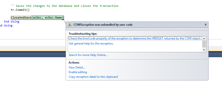

Here is where my problem is.  I can't figure out how to save and close the file, before the next one gets open.  Right after I use the Commit, I try to execute CloseAndSave(acDoc, acDoc.Name) and this gives me an error.  Any ideas what I am doing wrong?

                    tr.Commit()

I found the fix.  It was CommandFlags.Session
