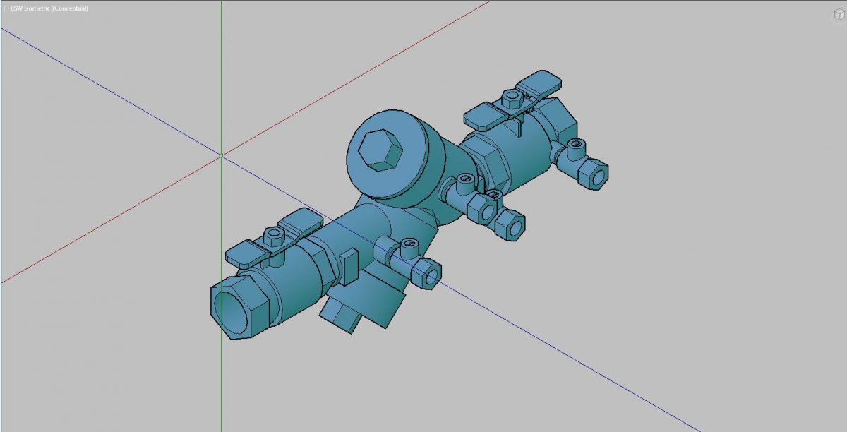

I have not dealt with 3D Models in a while and I am bit embarrassed to have to ask for help with this.
A valve manufacturer has provided me a 3D model of their valve. I can select the view modes under model space (TOP, RIGHT & FRONT) and I can choose HIDDEN mode view. This gives me the desired outcome that I need in 2D. But I am struggling to convert these views into 2D model to bring and use them on my drawing.
I tried using FLATTEN but the conversion does not render the object in the way that I need. I tried FLATTEN with the hidden lines options on & off. I would expect this to be the answer but apparently I must be missing something else.
Original 3D Model:
Front 3D Hidden View  (this is how I want the 2D flatten model to look like):

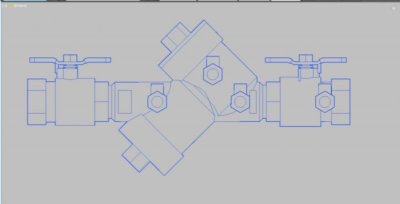

2D Model after FLATTEN  (flatten with and without removing hidden lines option):
Thanks in advance,

Very interesting commands Mark, thanks for sharing them. I have never tried them before. Ok, here are the results:
- Flatshot does convert the 3D model into 2D model, but it produces similar results as FLATTEN. Very close to the view I need, but with wireframe and showing hidden lines.
- ViewBase is a very interesting command, but it seems to create views in paperspace and not really convert the model into 2D. Not what I am looking for.
I am basically looking for a 3D to 2D conversion without the wireframe and removing hidden lines, so I am left only with the minimal plan view of the model.
BB

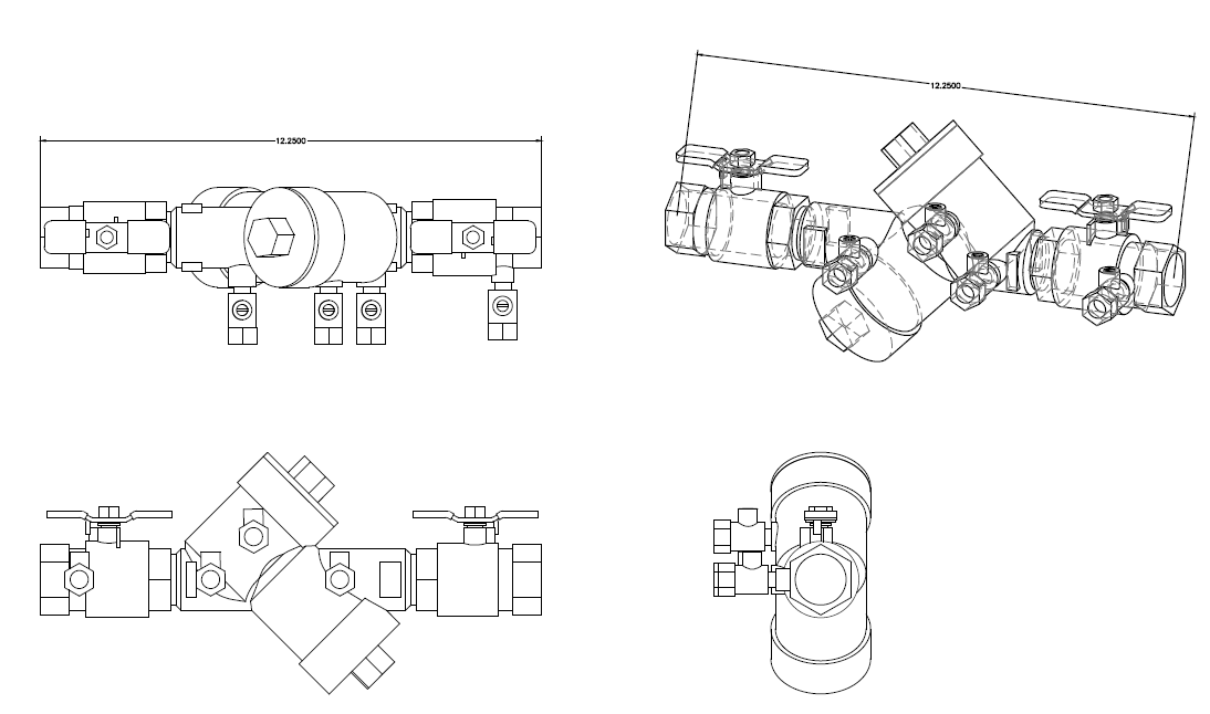

My results using the FLATSHOT command look like this.
As previously mentioned the ViewBase command utilizes paperspace.  What is created is called a "drawing view".
Other ways of creating 2D views of 3D models include the SectionPlane, SolProf, and the combination command SolView/SolDraw.  Again, I suggest you read up on these commands, test them even, then decide if any of them meet your needs.
Mark,
The views you have posted are exactly what I need. I am running ACAD 2017 Full. What would cause my results to differ from yours, when the command is pretty straight forward and not a lot of settings?
Why am I not getting the results you are getting? Any idea?

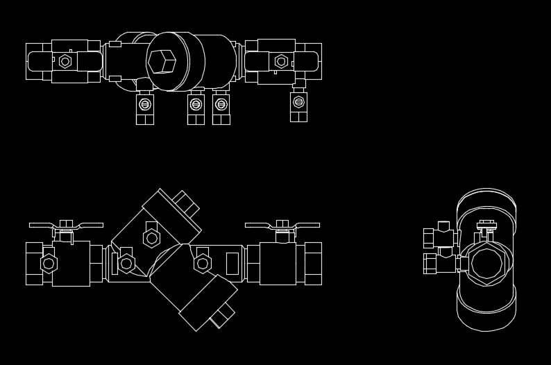

I'm not sure why our two results do not match other than to ask if the drawing you are working on has additional geometry than the one you posted.  See below for copy of my drawing (saved in 2010 file format).
1-950XL.ReMark.dwg
Edited by ReMark
1-950XL.ReMark.dwg
Mark, thank you. It works well.
This is not something that I go thru regularly, so I won't try to figure this out but simply use your drawing instead.
Thank you very much.
You're entirely welcomed.  Glad I could help.

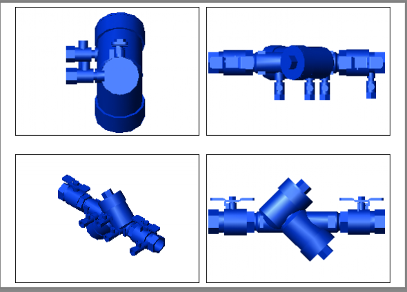

2 minutes ago, BIGAL said:
Using layouts and simple views is this useful.
BIGAL,
I am sure this is useful for someone asking about how to create different views for a 3D model.
My request was for a 2D conversion to be used on 2D drawings.
No worries, some companies have their parts as 2d & 3d the supplier does not have these two types available ?

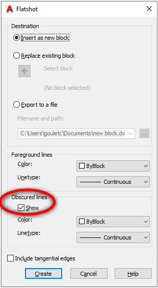

BB
Just notice that when you use the Flatshot command you can always select to add or remove the hidden lines (obscured lines). In your case you will only have to make sure to uncheck the box (show) to have it looking like you would like to . I hope it will help you for your futur use of this command.
