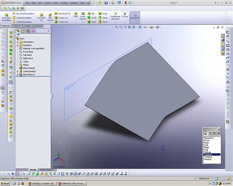

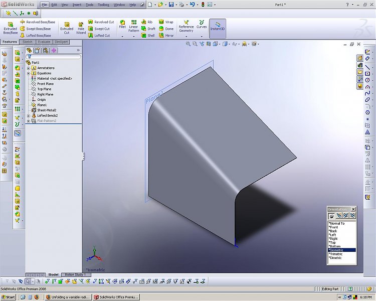

Unfolding a variable radius bend
try a "Lofted Bend"
Thank you Cedar! I was able to do exactly that and it work.

cedar probably has described it the best way, by using the loft command.
Shift has done it in a way most cnc machines would cope with this type of manufacturing of the radius.
