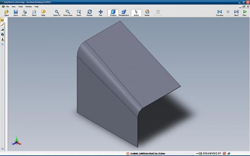

tuxarut Posted January 22, 2009 Posted January 22, 2009 Hello I am trying to unfold this part into a flat pattern to be cut. The top radius is 6" and the bottom radius is 4". I attached a screen shot of the part as well as the solidworks file (rename the .zip extension to .sldprt). I made the solid part, added a variable fillet then shelled what I didn't need. I am unable to unfold it to a flat. If anyone has a better Idea for developing the flat I am open to suggestions. The customer is wanting this asap and I am under the gun. Please help. part.zip Quote

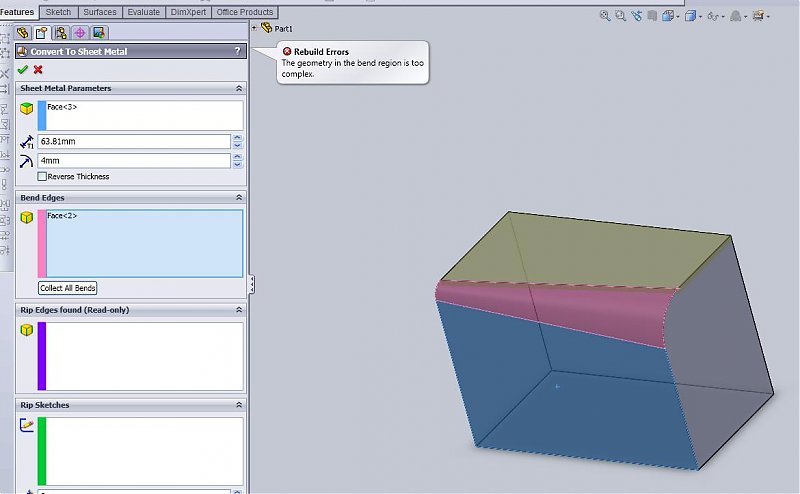

shift1313 Posted January 22, 2009 Posted January 22, 2009 the zip file is corrupt and will not open. I dont think you can unfold a solidpart unless you are making it in the sheet metal function. That part can't be bent, it needs to be formed so the metal can stretch. Here is an example for you. I drew a solid block and created a variable radius corner, tried to use the convert to sheet metal function and got the error below. I think what you need to do is create a forming tool and apply it to a sheet metal piece. I dont have any experience with this. what is the client looking for? Quote
shift1313 Posted January 22, 2009 Posted January 22, 2009 i got the file to open renaming it like stated above. also as a note, my first screen shot and second screen shot contain two different bends Quote
shift1313 Posted January 22, 2009 Posted January 22, 2009 sorry man but i dont think its possible. I am vairly certain a variable radius sheet metal piece needs to be formed. Im not sure if 08 has forming tools but im pretty sure they do. Does your client need a way to bend this? Quote

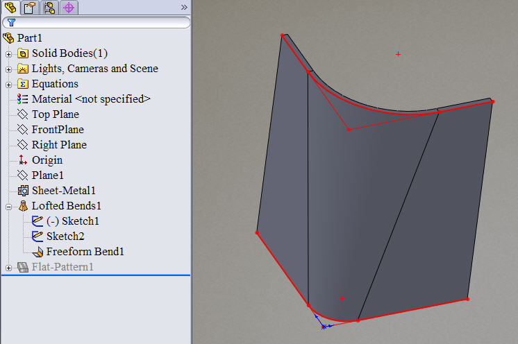

shift1313 Posted January 22, 2009 Posted January 22, 2009 i still havent found a way to do it. Maybe lofted bend would get you close but i cant find anything to exactly replicate what you want because i dont think SW cand stretch the metal. ill play with it again when i get the chance Quote

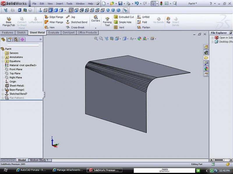

ramsay Posted January 22, 2009 Posted January 22, 2009 Still learning solidworks myself only way i could do anything like is sketching bends in manualy 6 degree at at time. Quote
