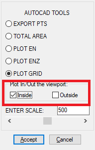

Need your help on how should I be able to set a string depending on the toggle key value:
Here's the code...
DCL
 :boxed_row {
    key = "InOut";
    label = "Plot In/Out the viewport:";
 :toggle  {label="Inside";
    key = "in";}
 :toggle  {label="Outside";
    key = "out";}}

Toggles are check boxes. Are you planning on both "In" and "Out" being checked, or is this an "either or"? If the latter then i would switch to using radio buttons. Much easier to control and a single variable to up date if either is selected.
Here's what it looks like, what I want to achieve is when I select "inside" grid coordinates will be drawn inside the viewport and otherwise it will be plotted outside.
@ dlanorh the reason why I prefer to try to use toggle key just to make my dialogue box more presentable because I already have radio buttons.

; you can use toggles but they are normaly used when multiple conditions can be true (which are called 'options')
; In your case, there should only be one option true, you're either inside or you're outside
; unless of course you are a cat writing this program on your quantum computer. If not? : meet the radio button

Heres some simple example, to simulate a radio_row with toggles :

Thank you so much guys for time. @ Grrr I will try to analyze the code you suggest to fit in my existing codes.
Problem solved!!!
Thank you so much guys... 'til next time.
Special THANKS to Grrr, that is what I am looking for by forcing the toggle to select either in or out.
