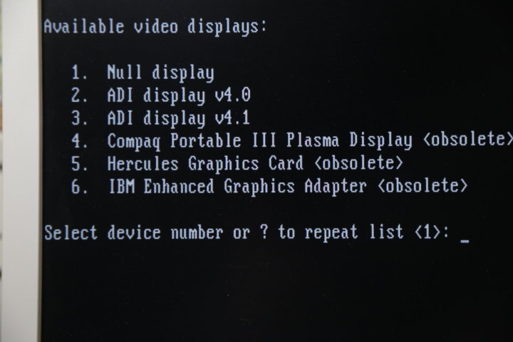

acad_2k Posted December 21, 2019 Author Share Posted December 21, 2019 here are my options Quote Link to comment Share on other sites More sharing options...
acad_2k Posted December 21, 2019 Author Share Posted December 21, 2019 I tried option 6 which got me to the drawing editor but the text was garbled. I then tried 2, now I can't open autocad due to a display error. Quote Link to comment Share on other sites More sharing options...
RetroCAD Posted December 21, 2019 Share Posted December 21, 2019 My apologies, I had forgotten that stock AutoCAD R13 for DOS has relatively few drivers. Give me a moment here and I will send you a proper driver. 1 Quote Link to comment Share on other sites More sharing options...
RetroCAD Posted December 21, 2019 Share Posted December 21, 2019 This is a legacy Vibrant Graphics driver for R13. Copy it to your DRV folder (which for you is probably C:\ACADR13\DRV). After doing this, a new option should appear in the video selections. The first time you choose it, the driver will complain about not having a config (CFG) file, but carry on and use the default setting which is 640x480 VGA. If the future you can go back into the config and choose a more specific setting within this driver (based on your graphics card) and run at very high resolutions. DL153100.RES 1 Quote Link to comment Share on other sites More sharing options...

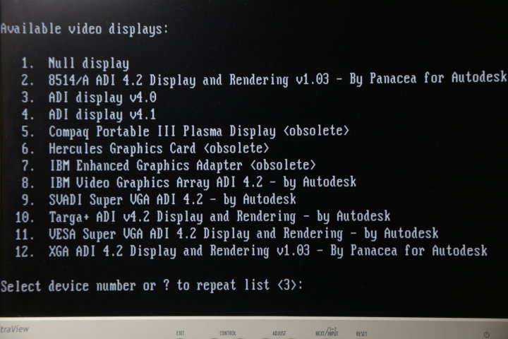

RetroCAD Posted December 21, 2019 Share Posted December 21, 2019 The new option will look like #2 shown here. Quote Link to comment Share on other sites More sharing options...
acad_2k Posted December 22, 2019 Author Share Posted December 22, 2019 okay, here are the options... Quote Link to comment Share on other sites More sharing options...

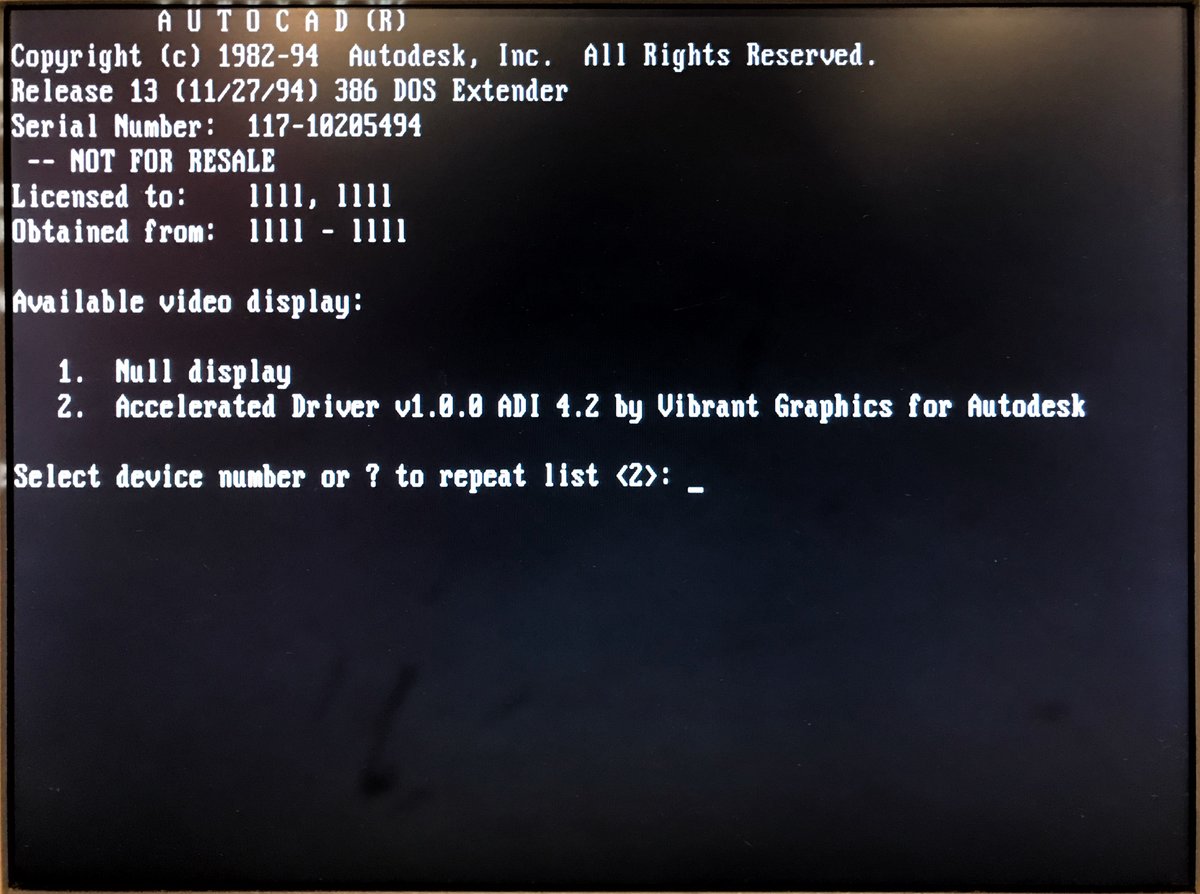

RetroCAD Posted December 22, 2019 Share Posted December 22, 2019 Well, these are certainly different than your previous screenshot. For now, I would select number eight (8) "IBM Video Graphics Array". 1 Quote Link to comment Share on other sites More sharing options...
RetroCAD Posted December 22, 2019 Share Posted December 22, 2019 For real, I wish I could teleport there for a few minutes and sort this out for you! 1 Quote Link to comment Share on other sites More sharing options...
acad_2k Posted December 22, 2019 Author Share Posted December 22, 2019 SUCCESS!!!!!!!!!! Quote Link to comment Share on other sites More sharing options...
