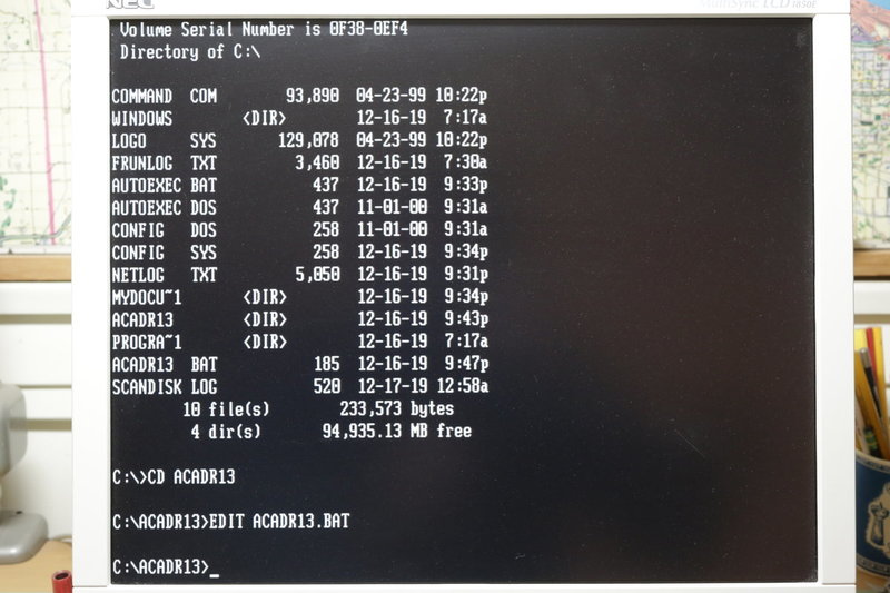

acad_2k Posted December 20, 2019 Author Posted December 20, 2019 I read some of the Autocad R13 "Installation For DOS Guide" and made an attempt to edit the Autocadr13.bat file (I really don't know what the hell I am doing), anyway, here is a screen shot... Quote

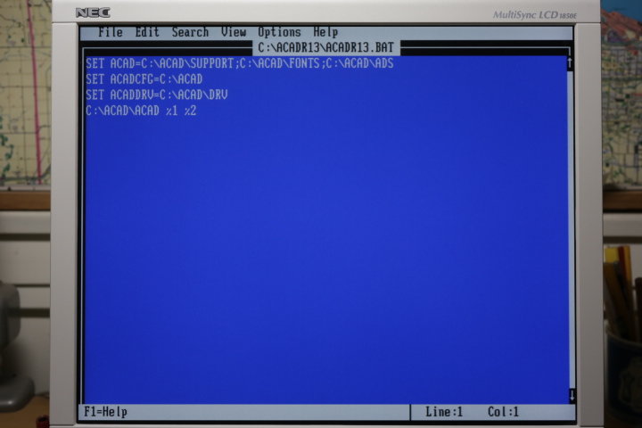

RetroCAD Posted December 20, 2019 Posted December 20, 2019 Seems like your AutoCAD folder is named "ACADR13" so make sure you are reflecting that correctly in your batch file. In your case it would be: SET ACAD=C:\ACADR13\SUPPORT;C:\ACADR13\FONTS;C:\ACADR13\ADS SET ACADCFG=C:\ACADR13 SET ACADDRV=C:\ACADR13\DRV C:\ACADR13\ACAD %1 %2 Attached is my ACADR13.BAT for reference. 1 Quote

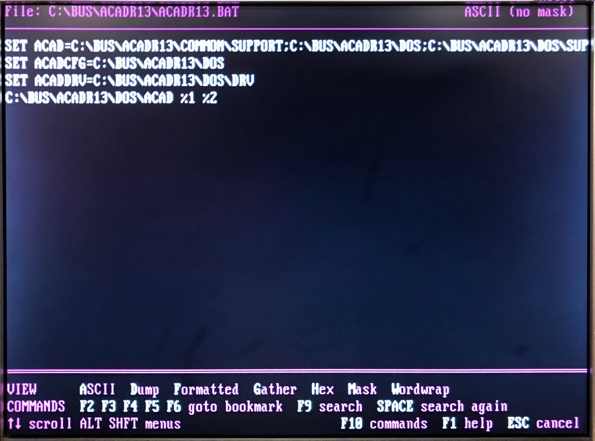

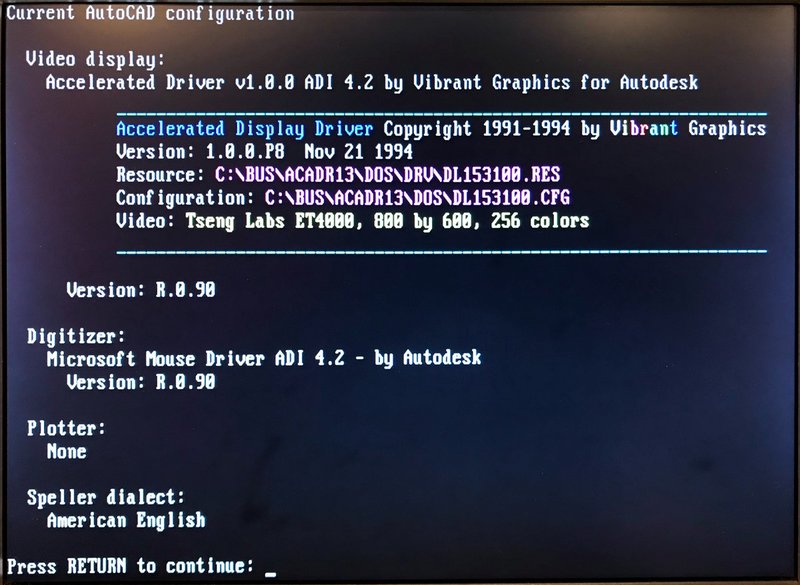

RetroCAD Posted December 21, 2019 Posted December 21, 2019 On 12/21/2019 at 4:58 AM, acad_2k said: I updated the file, but no luck. Whenever I start autocad, I get a "command" prompt (COMMAND:) but no drawing editor. Expand This sounds like a configuration problem. At the Command: prompt, please type “config” and press enter. You will be presented with a screen that shows your current configuration. For reference I am attaching the screen I see when typing this command. Please take a photo of what you see and post it here. Quote

acad_2k Posted December 21, 2019 Author Posted December 21, 2019 When I first start AutoCAD from the DOS prompt, C:\, the start-up page reads: "BASE.dcl" : Can't open file Error loading dialog control file Press RETURN to continue RETURN prototype drawing acad is not on file. Using defaults Press RETURN to continue RETURN login was successful "TXT.shx" can't open file RETURN enter another font file name for style STANDARD (or RETURN for none) RETURN "ACAD.mnu" can't open file RETURN enter another menu file name (or RETURN for none) RETURN Command: So now I will try "config" at the command prompt. video, digitizer, plotter configs that I chose during install (none) are what is displayed RETURN Configuration menu: 0: exit to drawing editor 1: show current config 2: allow detailed config 3: config video 4: config digitizer 5: config plotter 6: config system console 7: config operating parameters Enter selection (0): I'll wait at this stage for instructions Quote
RetroCAD Posted December 21, 2019 Posted December 21, 2019 What video did you configure for AutoCAD? Quote
RetroCAD Posted December 21, 2019 Posted December 21, 2019 All of the “Can’t open file” messages indicate that you need to use a batch file like the one we were initially working on. Those SET strings are used to tell AutoCAD where to find those files. Quote
acad_2k Posted December 21, 2019 Author Posted December 21, 2019 On 12/21/2019 at 9:11 PM, RetroCAD said: What video did you configure for AutoCAD? Expand I used "null" display. The options given were unfamiliar. Quote
RetroCAD Posted December 21, 2019 Posted December 21, 2019 On 12/21/2019 at 9:41 PM, acad_2k said: I used "null" display. The options given were unfamiliar. Expand That is the problem. Select VGA instead. Quote
