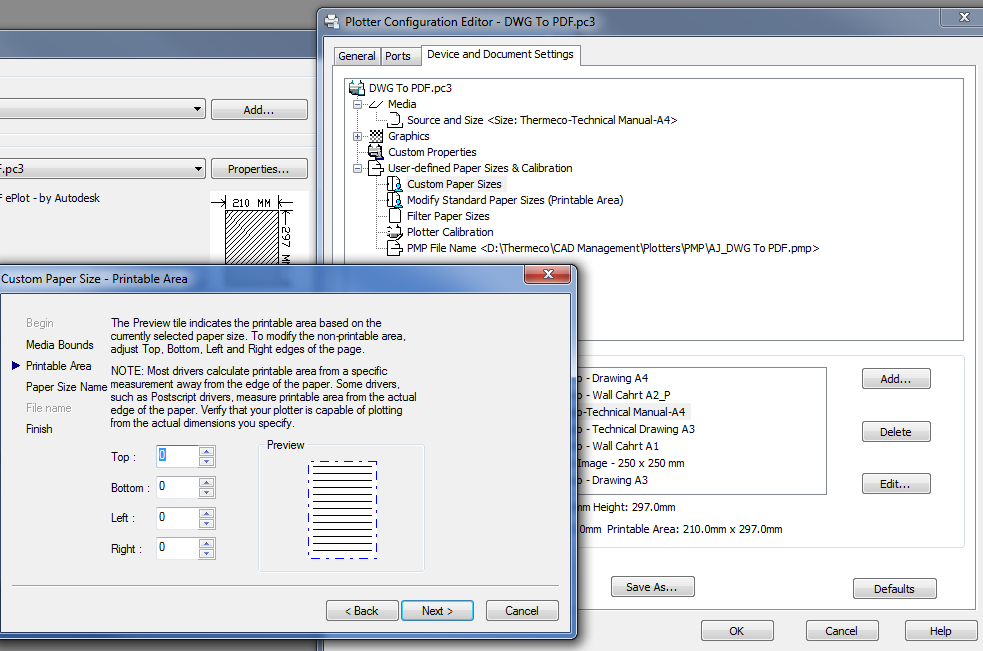

I have gone to the properties to change the printable area on a custom paper by right-clicking on a layout tab -> Plot.

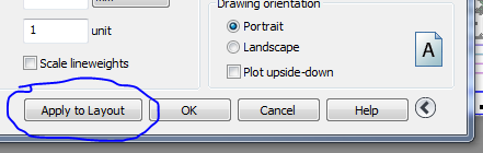

After this, to make these changes happen I need to click on "Apply to Layout".
The good thing is the new "printable area" has been saves to pc3; however, I need to repeat myself over and over by right click on every single layout tabs and click on:
Is there any way to apply these changes to all layouts at once?
