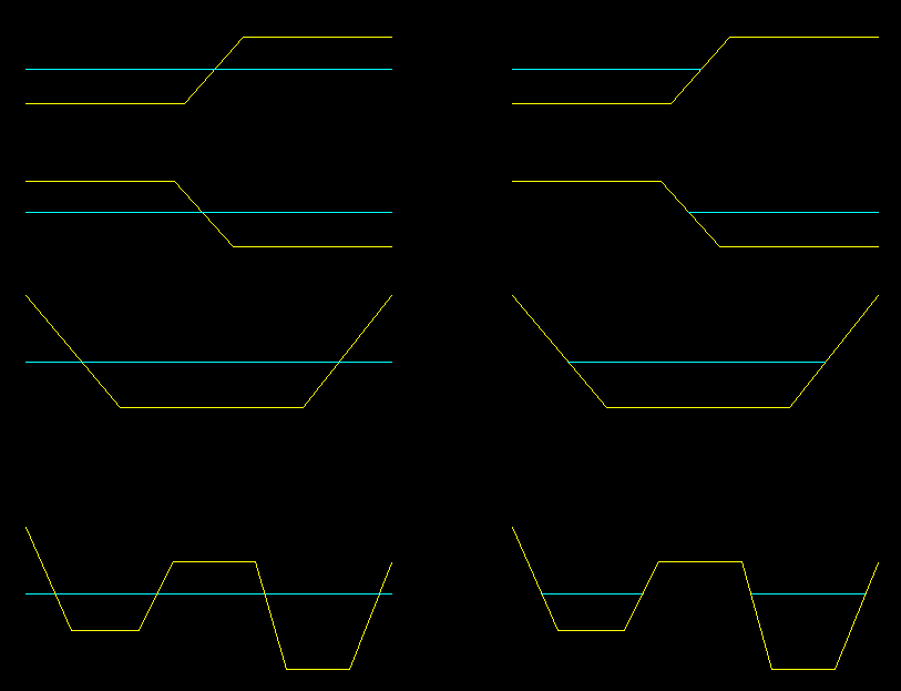

got myself a question now, wich i realy cannot solve myself this time...
On the left side 4 cases, with on the right side the desired results.
The case can be anything between these, but will be shaped like this in some way.
I want the blue line to be trimmed on the yellow one, but the blue line must always remain above the yellow one.
Yellow = earthwork, blue = water.
There is always one yellow and one blue line.
lets say...
!waterline = blue entity
!earthline = yellow entity.
Hope somebody can do me a suggestion. 😉

Calculate your intersection points and draw it correctly in the first place?
Few words to solve the puzzle:
• GetBoundingBox method (activeX),
• Ray casting method (algorithm in LISP)
• Break Sub by CAB
• This pseudo-conditional:
(if (DoesAVerticallyCastedRayFromTheBlueSegmentIntersectsTheYellowLine BlueSeg YellowLine)
  (erase BlueSeg)
Right now I don't have time to assemble it, so good luck solving! :)

What sort of line entities are the earthline and the waterline?
Oops :(   Senior moment :oops:
I'd do it slightly differently to Grrr, but the approach is much the same
Get the two polylines
Get the coordinates of the waterline
Find the insersection points and feed back into the waterline polyline.
collect the line objects made from exploding the waterline (code below)
(setq l_objs (vlax-invoke wl_obj 'explode))
delete waterline
loop through line objects in l_objs
        insert an xline (per to) at the mid point of each line object
       get the intersection between the xline and the earthline
      delete xline
      If the mid pt y coord less than the intersection point y coord  add line obj to delete list
end loop
remove delete list objs from l_objs and delete
run the remaining lines in l_objs through pedit (peditaccept set to 1)
Edited by dlanorh
Hello all,
Solved the problem, by instead of trimming the line, drawing the line where it should be.
The program loops trough all vertexes. Checks current and next point, it it intersects, it calculates the points.
