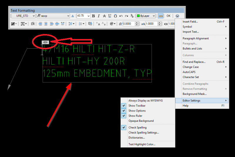

In the MTEXT editor... what is the option to control the display of the frame around the text?  I am not trying to draw a frame around text, or create a background mask.. I am only interested in the frame around the MTEXT while in the MTEXT editor.

@CyberAngel I would like to be able to toggle the display of the frame.  I have it enabled in ACAD2014, and would like to enable it in ACAD2015.
@SLW210 you are correct that assigning a width to the MTEXT will enable the frame, but in ACAD2014 it is possible to display the frame when MTEXT has zero 'defined width' (that what the screenshot shows).

Thanks for the reply and suggestions CyberAngel.
Unfortunately neither of those system variables are able to restore this border around the MTEXT during edit.  Using 'oldeditor' presents the MTEXT in a little pop-up style window, and the text is strangly illegible for some reason (kind of grey and smeared - looks like monitor resolution issue).
