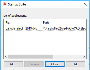

JCEP2019 Posted February 7, 2019 Posted February 7, 2019 We have some customized printing buttons and lisp routines that load during our ACAD startup for our users here. This was working fine in our previous rollout (2014 ACAD, I know, it's been a while). We are in the process of trying to roll out 2018 and when we open ACAD either by running the program, or opening a drawing, the customizations called for in the ACAD.DVB file simply won't load. However, when we then open another drawing, either by opening a new drawing in ACAD, or opening another existing CAD file, the ACAD.DVB processes and loads all our stuff just fine. We simply cannot get it to load on initial startup for some reason. I can provide logs/info or anything else that will help us get this ironed out (as long as you tell me what logs/info you are looking for).. Some stuff we have tried already- ACAD.DVB is located- "C:\Program Files\Autodesk\AutoCAD 2018\Support\ACAD.DVB" "C:\Program Files\" was located in the Trusted Paths list, but I also just tried adding "C:\Program Files\Autodesk\AutoCAD 2018\Support\" and this did not correct the issue. I then moved the "c:\program files\autodesk\autocad 2018\support\" from #2 position to #1 position in the Support File Search Path and this also did not correct the issue. If we load the dvb using VBAMAN, then go to Tools>References, no references show as MISSING. Thanks! Josh Quote

Arthurian Posted October 22, 2019 Posted October 22, 2019 See the ADD button in the "Startup Suite" window? You can use it to add ACAD.DVB, and bypass all the LISP file stuff. But, oh man, it took me all afternoon to figure that out! Quote
