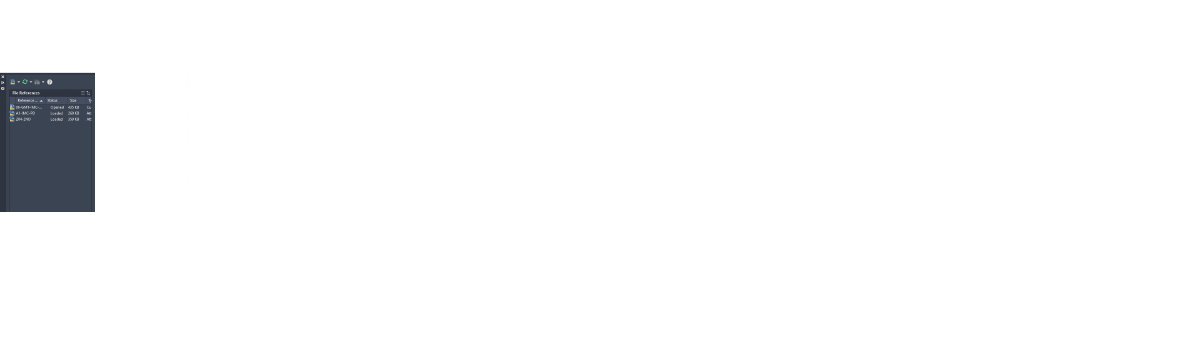

 hi rlx. i already try this code . after i put "name of xref you want to detach". nothing all happen you can see on picture i attach
sorry , your picture is to small to see anyting.

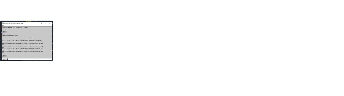

sorry my mistake . i already reattach with new picture. and the problem is  i already try this code . after i put "name of xref you want to detach". nothing all happen you can see on picture i attach

Hope these work better. Think the bug is (was) the strcase function. The xref name you typed in was converted upper case and the name of the scanned xref converted to lower case.

This sort of worked for me and also sort of didnt. I am green to using LISPs like this so please bare with me. I was able to get my xref into all of my drawing files, however, I had to change the 'attach' selection to 'overlay' as that is how my company wants xrefs done. My biggest issue however was that I wasnt seeing any of my xref linework, the file was there in the manager but nothing was appearing until I right clicked on the xref and selected 'attach' then it would "re-attach" and all the linework popped in. So while I didnt have to path to every file each time I still had to do something in each file to get it to work. any suggestions? I am past this particular project but would love to have a working .lsp for future use cases. Thank you!

So this one worked to get the xref to be an 'overlay' attachment type and is on the appropriate layer, but I am still left to go into model space and "re-attach" the xref to get the linework to appear.
**EDIT gosh I feel dumb, I found out what the issue was, this lisp was putting my xref in paperspace. What part of that routine do I need to change to get the xref inserted into model space??

Thanks for the reply! It looks like I am already using the one that is supposed to go into ModelSpace but I am thinking that it just inserted the xref on the layout that was active when it opened the file.
Thanks again for the response, I know this is like 4 years old so just a response is nice lol
