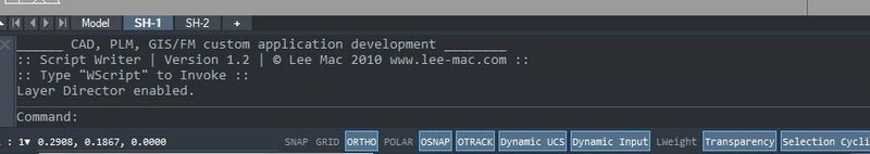

1.Batch Detach All Old Xref's using Script Writer
WSCRIPT >
Use script line:  _.open *file* _.xref _D * _.zoom _E _.qsave _.close(i tried also this one.it does not works for me)
this script line is not working for me.can anyone help me?
_.open *file*"C:\Users\thajmul hussain\desktop\fais\try\Template.dwg" _.xref _D

hi lee,
1.it does not popup a message in the commandline logging while using this script (_.open *file* _.xref _D * _.zoom _E _.qsave _.close)   i attached the image. kindly see the first image.it's blank.

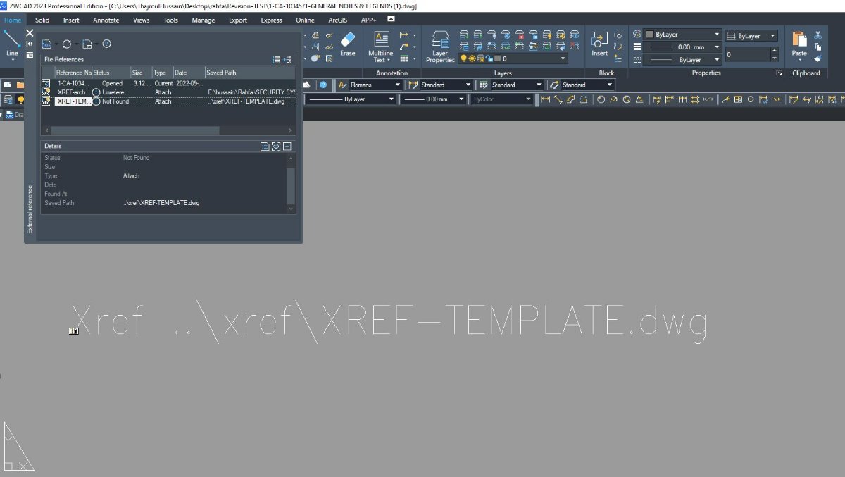

2.i want to know what script line to write for the update path because i have a bunch of drawing to update.
kindly see the second image.

hi rlx,
can you modify your code according to "select new path"?
thanks advance
Hi Thajmul,
not sure what you want , you wish to select a folder and then update the xrefpath for all drawings in this folder?
  On 9/27/2022 at 11:30 AM, rlx said:
Hi Thajmul,
Expand
kindly see the image you would like to know. what i am trying to asking.the Xref drawing appear not found and another drawing appears unreferenced
maybe in the code you should change the xref path type from 1 to 0 ?
(RLXref_SetPathType 1) -> (RLXref_SetPathType 0)
Expand
hi rlx
sorry to ask again. nothing happened.kindly see the image
no problem thajmul
Apparently the xref you are trying to attach is already in your drawing so you would first have to erase / detach the xref & purge the drawing. Probably best to use a normal script for that because I'm not sure this can all be done with odbx (little out of practice because of murdering workload , but what else is new). Other problem , I mean challenge , is that your (network) paths are unique for your situation making it difficult for someone else to replicate your problem. The routine you use has little error trapping for this , just displaying what the error was.
