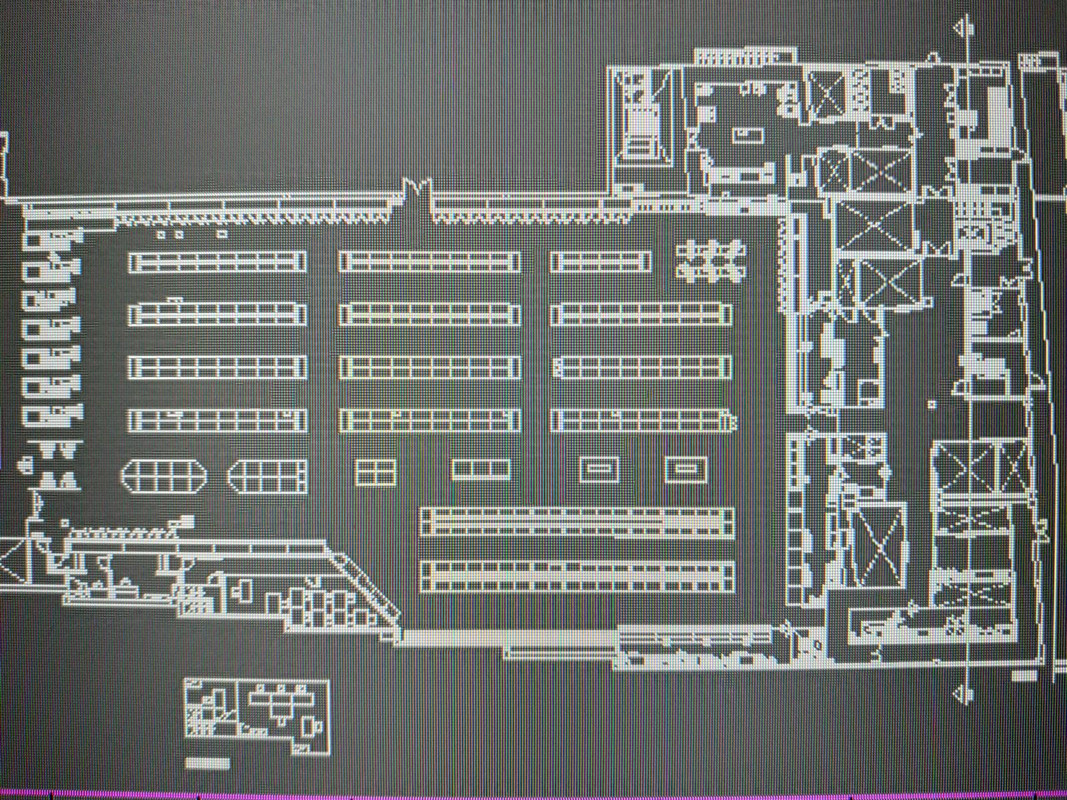

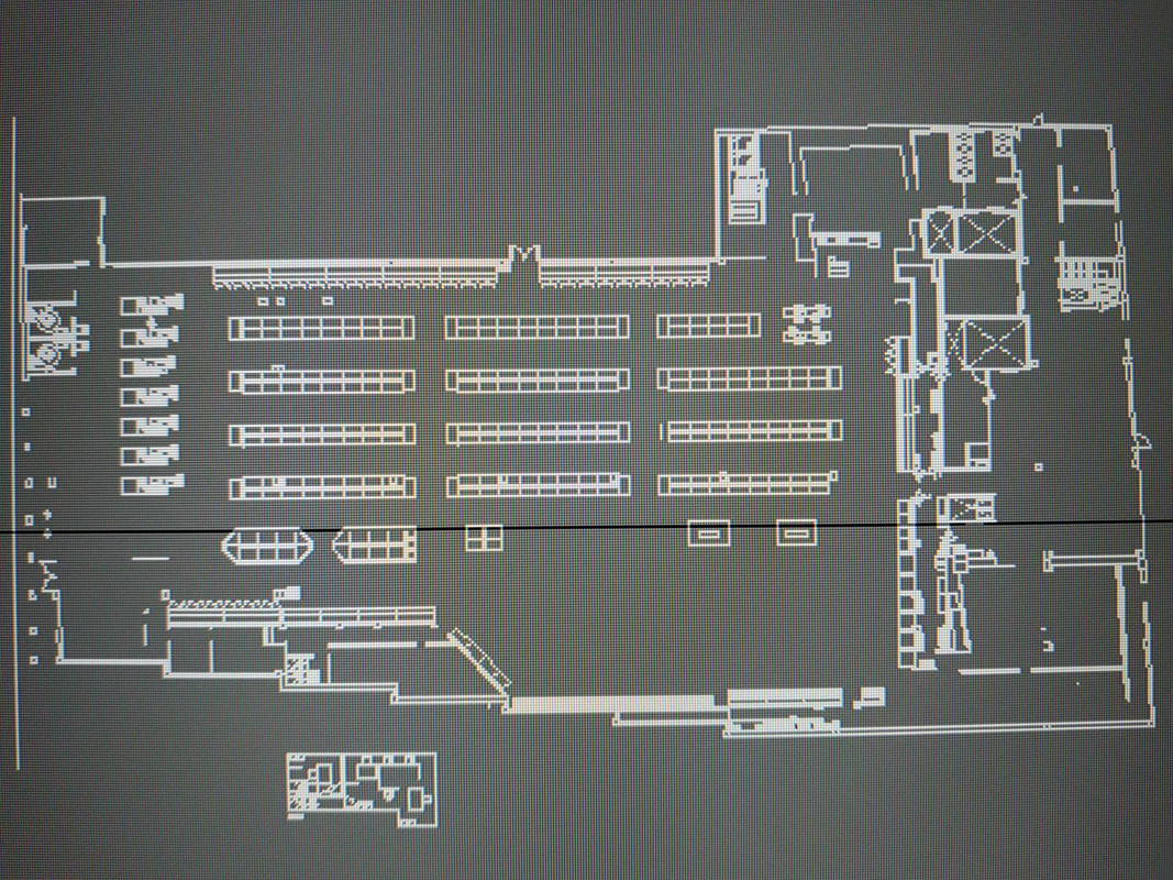

I'm trying to copy an object into another drawing, but it does not appear in full, it's almost 50% missing.
I already tried copy paste, make a block, etc and nothing.
It's all on the same layer.
ORIGINAL:
COPIED:
What can it be and how to solve it?

My guess would be that your clipboard overflowed. That's a lot of data. From a data management standpoint, it would make sense to separate that "object" into several layers or areas and copy them in stages.
Another obvious possibility is to xref the object. You can then bind it into the destination drawing. Or not.
You mentioned making a block, did you try Wblock to export and then Block|Browse to import? In other words, create a third file as a staging area.

Solved using AutoCAD 2018.
Copy Paste.
Didn't try the other options.
