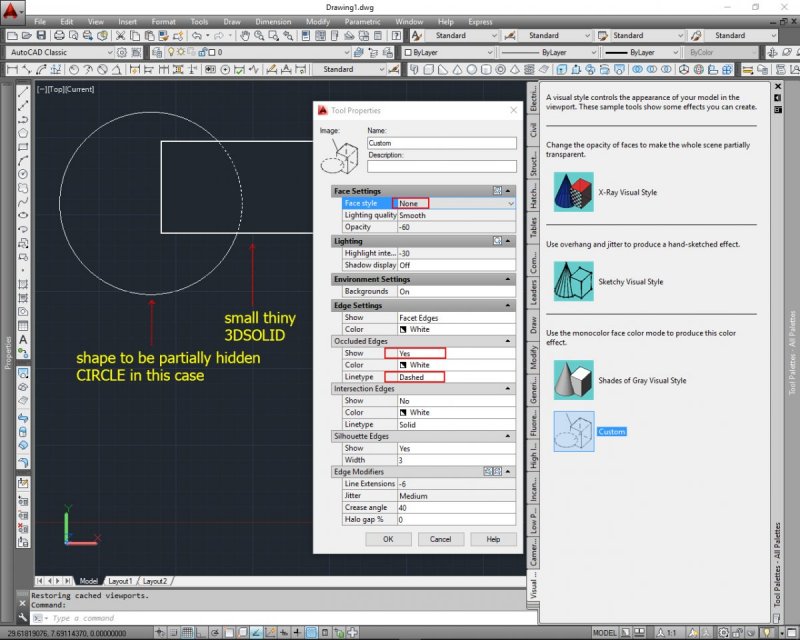

You can try something like this :
- I've set OBSUREDLTYPE=5
- I've set VSOBSCUREDLTYPE=5
But I think that this doesn't influence on later setting of custom Visual Style... Instead of BLOCK - You have to create thin 3DSOLID that overlaps your other shape - BLOCK...
Look in picture - those settings marked red are necessity...
Actually, you don't need to make thin 3DSOLID, you can do it with REGION the same... Just move BLOCK with REGION outline slightly on higher elevation than the shape that you want to partially hide with dashed lines... Settings for Visual Style you need to apply are shown in above picture...
HTH., M.R.

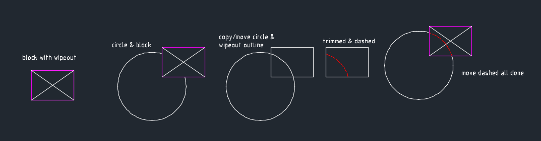

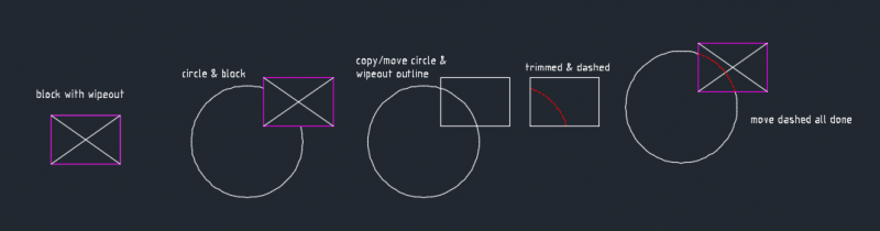

Its complicated working out the outer shape of two random blocks and how they intersect. Again I think making two outer boundaries would be the best way but trimming the correct section hmmm, and make it it dashed. Cookie cutter comes to mind to get the remaining section.

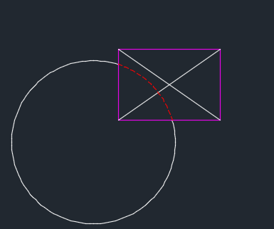

image.png.51fbdc6cdfc54d7754187fb04a04f523.pngimage.thumb.png.ac8c812ecbb97ac786733086e1654945.png

Thank you all for your inputs. Actually i'm doing what BIGAL is suggesting.
