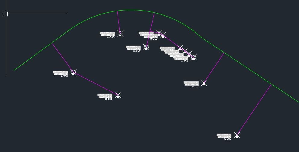

Hi, I'm a newbie to autocad LISP and also to the forum. I have to create perpendicular lines to a polyline from points adjoining to it. I can manually do that one by one but I have several thousand points either side of the very long polyline and it is difficult to do that one by one. Is there anyway i can quickly draw perpendicular lines from the points to the polyline. the drawing is 2D and below is a small sample to of the drawing just to illustrate.

Dear Emmanuel Delay, Thank you very much. The code work very well and it does what I want.

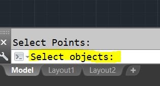

Just one thing to ask, the text display on the command line always says "Select Object" in both instances (i.e. ask to select 'polyline' and 'points'). see below images. Is it possible to change to 'Select polyline' and 'Select Point'?
Thanks again. 👍
Yes, for example like this:
  (setvar "nomutt" 1)  ;; shut up ssget

  (princ "\nSelect Points: ")
  (setq pts_ss (ssget (list (cons 0 "POINT"))))
  (setq ss_len (sslength pts_ss))
  (setvar "nomutt" 0)  ;; set the variable back

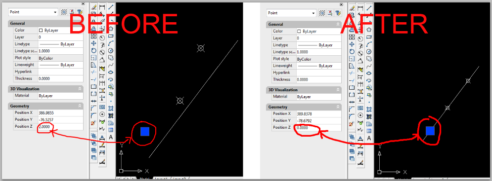

Can any of the routines provided here be modified to move a lot of points to a selected polyline at the location where they would intersect perpendicularly.
 Try this

@dlanorh Thank you for your response.  I tried your routine and it wont allow me to select my polyline.  I am not very familiar with the language. perhaps this is what @ronjonp is referring to in his comment.
Also, after thinking about it, I would also like to have the option to move points OR text.
If you want to move points or text simply change the filter:
(setq ss (ssget '((0 . "POINT,TEXT"))))
I tested @dlanorh code above and it works fine?
  • Thanks 1
@dlanorh @ronjonp Thank you both so much!  The problem was that my polyline was a 2D polyline, so once i converted it the routine worked like a charm. This will save me a lot of time.
