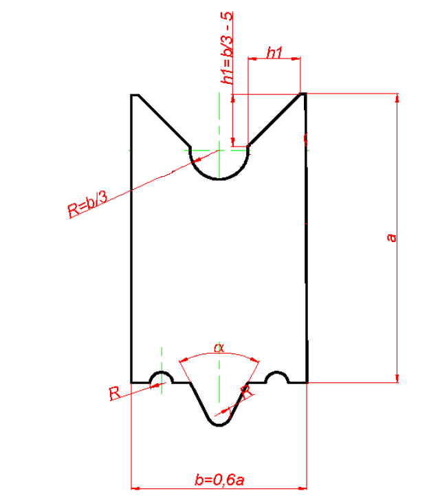

Hello. I am a student and I need your help😉. My task is to write a program in AutoLISP that draws parts but I have no idea how to do it. The program in the simplest version which is only possible - I know that for some of you it's a bit of a job, so if it was possible, I would ask for help. I will try to repay somehow 😉. Greetings. 👊 Sorry for my English.
You need to start with the basics then use simple command method as a start. Keep using polar to work out new points and drawing objects like a circle then trim to clean up. look up the help for explanation of the commands below. There is some missing distances in the sketch you will have to make some choices.

Thanks ;). What is this mistake? The compiler shows that it is good.
The new version of Cadtutor double lines when I paste if you just copy and paste it will not work as it will skip over the getpoint and getreal. Paste it to vlide and run from there. If you paste a line at a time it will work just a quirk with copy and pasting to command line you have to know how many lines you can paste takes experience. I tested this version and it works.
