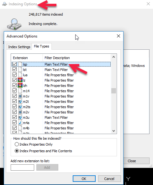

Index your lisp files to have a plain text filter like so. Then you can search easy peasy :)

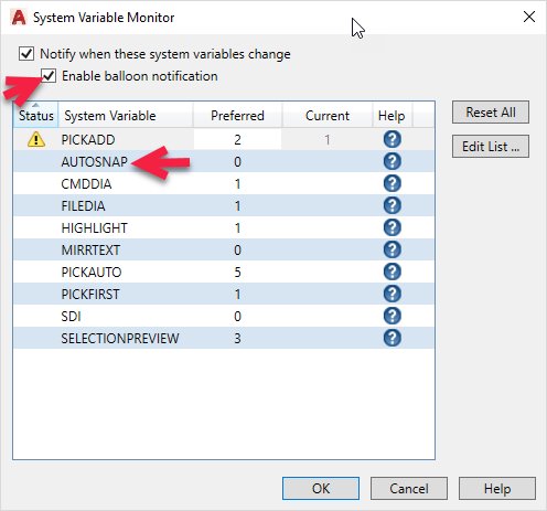

You could also enable the sysvar monitor depending on the version of AutoCAD you're using:
Edited by ronjonp
UGH!!!! my company has locked that down! they want to see me suffer! lol

well i have to say that this is a pretty cool lisp routine! sadly i did a search for 'autosnap' and it didnt come up with anything. is there anything else that i could search for?
Only thing I know about autosnap is to turn of the irritating thing 😄

3 minutes ago, rlx said:
If you google 'autocad autosnap problem' at least you're not the only one having problems...
that is what i found. i also looked up autosnap system variables. and found that you can add a string to override it and have it turn back on.
i added - (setvar "AUTOSNAP" 8 )      <--- there is no space between the 8 and the ) if i left it there in this response i would get this 8)
so my lisp and loaded it into AutoCAD and turned off polar tracking. and then ran the normal command that i do to reset my OSNAP's and bingo, it turned back on.
