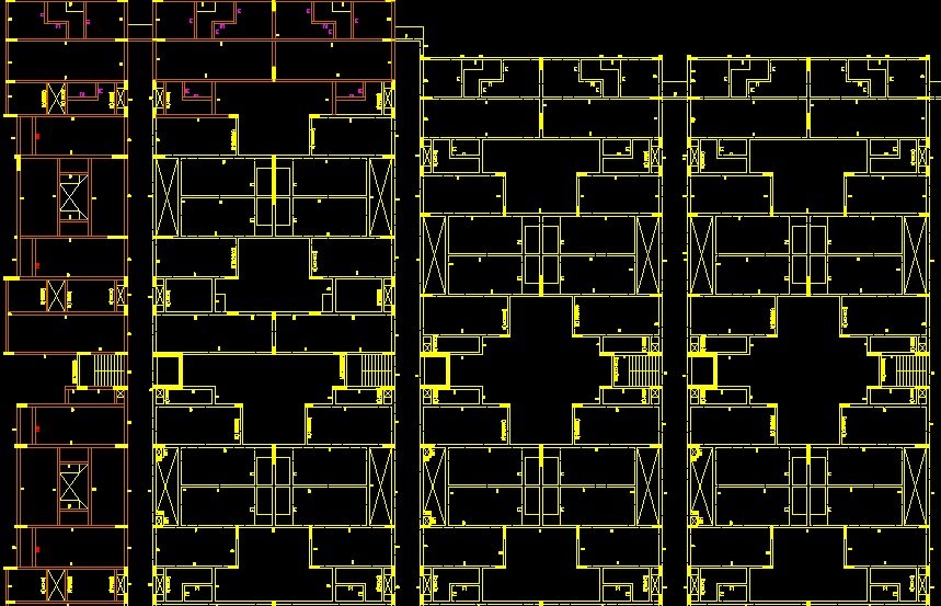

Dear Forum.
I have over 1000's of rectangles which represent walls.
i need to extract length and breadth of the rectangles while applying a unique naming code to each rectangle and want the results to be tabulated in excel format
UNIQUE CODE           LENGTH               BREADTH
RG1                                1500                      150
RG2                                  850                      150
and so on.....
Kindly advice...

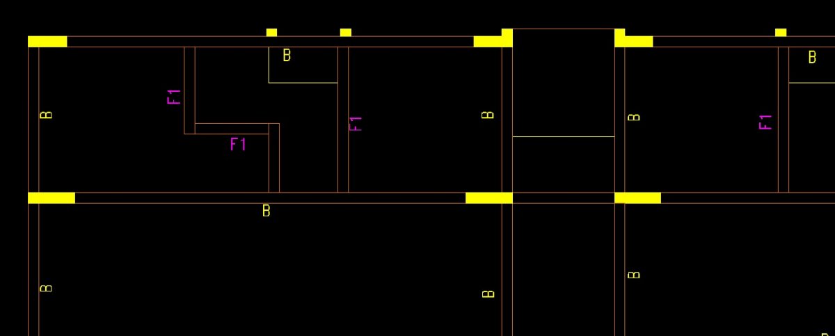

HI ronjonp.
PFA drawing file they are not actually wall but rectangles which i have drafted over the wall layout.
i need to extract length and breadth of the rectangles while naming them uniquely and exported to excel.
Thanking you.
RECTANGLE LANDB.dwg

Exactly what it should do....Blink of an eye...!!!
