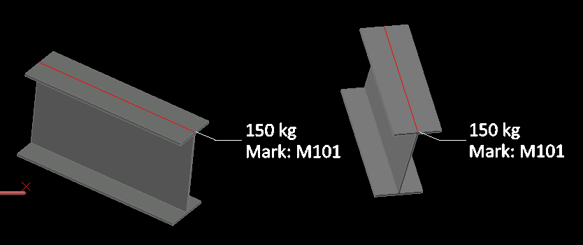

TunzaGibbo Posted December 22, 2018 Author Share Posted December 22, 2018 Thanks Grr & David I'm trying to establish weather the things I want to do in Autocad can be done in lisp. I use a program called Advance Steel and there are many enhancements I can think of to improve productivity. A lot of the enhancements are working in Model space on the 3D solid steel members that are created by Advance Steel. Can Lisp be used to access information about the properties of such members. As an example I want to label the end of a 3D steel member in Model space to show it's Weight and Mark Number. Because we are constantly changing the position we view the steel member from we would always want the label showing square to the screen and not oriented to the steel member. This particular Application would also need to be turned on and off as required. There would need to be a choice of member properties to choose from. Not just Weight and Mark Number. Is this something that could be done in AutoLisp??? Regards Tony Quote Link to comment Share on other sites More sharing options...

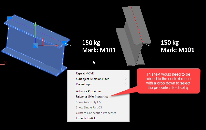

TunzaGibbo Posted December 27, 2018 Author Share Posted December 27, 2018 Thanks Bigal Advance Steel was 3rd party software but is now owned by Autodesk. Previously you needed to buy Autocad and Advance Steel as an Addon.Tthis was when Advance Steel was owned by Graitec in France. Ita now sold as just Advance Steel. This is an example of what I want to acheive: I want to label the end of a 3D steel member in Model space to show it's Weight and Mark Number. Because we are constantly changing the position we view the steel member from we would always want the label showing square to the screen and not oriented to the steel member. (See the 2 attachments) This particular Application would also need to be turned on and off as required. There would need to be a choice of member properties to choose from. Such as the members Model Role, Grade of Steel etc. Not just Weight and Mark Number. Regards Quote Link to comment Share on other sites More sharing options...
BIGAL Posted December 28, 2018 Share Posted December 28, 2018 Thats 2 questions still pretty sure that search here, getting properties of the beam was possible. The labeling would be done by flipping to ucs world not sure about a field for those properties. What happens when you use Mtext and fields. Need a sample dwg for any one here to have a look. Quote Link to comment Share on other sites More sharing options...
TunzaGibbo Posted December 28, 2018 Author Share Posted December 28, 2018 Thanks again The solid members created in Advance Steel won't work in Autocad. I need to convert them to Autocad solids. The only problem is that the properties of the Advance Steel member will be lost in the conversion. However in saying that getting the text to work correctly should still be much the same. I guess I could have an attributed block that inserts and this block could have the choice of showing certain attributes. The attributes would have to relate to the Advance Steel member properties. I can send a sample of the beams as Autocad solids but do you think that through Autolisp the Advance Steel member properties can be accessed. Tony Quote Link to comment Share on other sites More sharing options...
