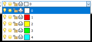

So It seems Autocad uses all uppercase letters for paper and model space. Where BricsCAD only use the first letter uppercase. so when looking a the list with vl-remove it seems to be case sensitive.
"*PAPER_SPACE"  /=  "*Paper_Space" so it wasn't removing them.
This should remove them now and not get stuck in a loop.

in my lisp collection i have this, but not remember the original source for give credit

thanks a lot works!! have a nice day
