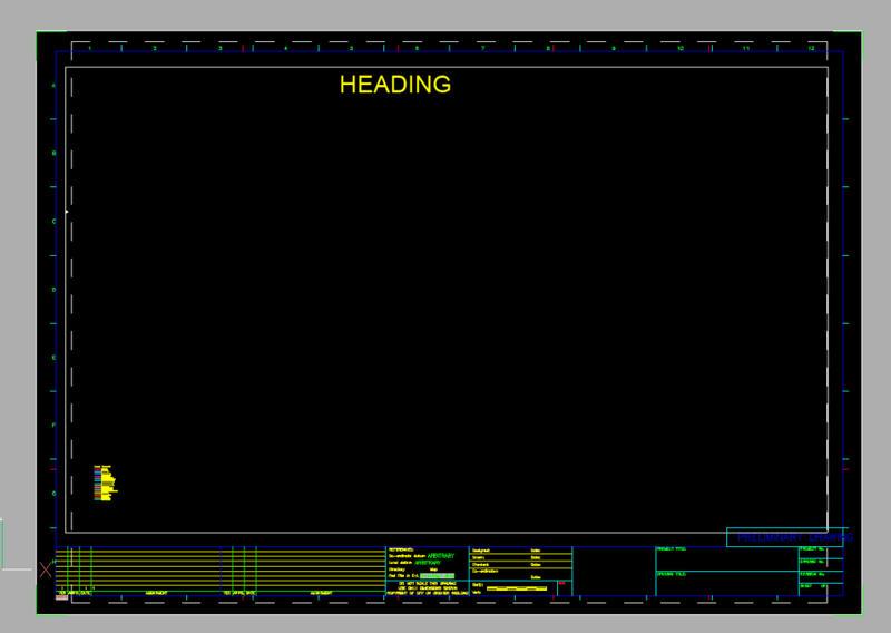

cup2cake28 Posted October 29, 2024 Posted October 29, 2024 So to get this right the instructions say, "Next, go to the Layout tab. The drawing would be plotted at a scale that will result in a finished 24″ × 36″ landscape plot, so the viewport needs adjusting to the correct scale to make the drawing fit. Select the viewport from Paper Space and change the scale so all the elements are shown. Be sure to lock the viewport so the scale won’t accidentally change as you work on the drawing. From the Layout tab, double check that your text, dimensions, and linetypes are readable at this scale, and adjust if necessary." Should I place a 24"x 36" square around the drawing? I've been looking at other students' drawings, and I did not see anybody do that. Quote
BIGAL Posted October 29, 2024 Posted October 29, 2024 (edited) You are correct draw a 24"x 36" square in a layout say on layer defpoints. Ok you can not plot to those sizes there are hard plot limits for a big sheet like that I would use say 3/8" all sides, others will comment, I am metric. Within this inner box size would be a Title Block matching 23.25x35.25. usualy have about 2" on bottom for dwg details. Then you make a Mview, matching that inner size. The little green corner markers would be your 24x36, you cna see title block and the white rectang is the mview which is well inside the title block. Edited October 29, 2024 by BIGAL Quote
cup2cake28 Posted October 30, 2024 Posted October 30, 2024 For some reason, I can not open my file, but how am I supposed to have a landscaped plot that's 24"x36" but my drawing is more than 72x52"? Is the landscaped plot referring to the model border? (I am working on Penn Foster's Structural Drafting project) Quote
ReMark Posted October 30, 2024 Posted October 30, 2024 (edited) Your structural drawing is in Model Space while your title block/border and viewport are in Paper Space. Am I right on both counts? If so, you can set the viewport scale to 1/4"=1'-0" and your building should fit within its confines. The scale factor I mention is fairly typical of architectural drawings. If you are satisfied with the results make sure to lock the viewport scale so you don't inadvertently change it. Edited October 30, 2024 by ReMark 1 Quote

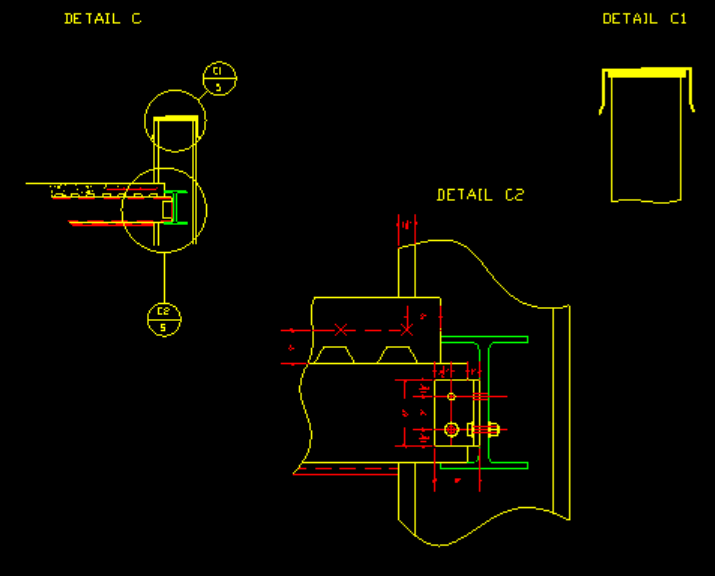

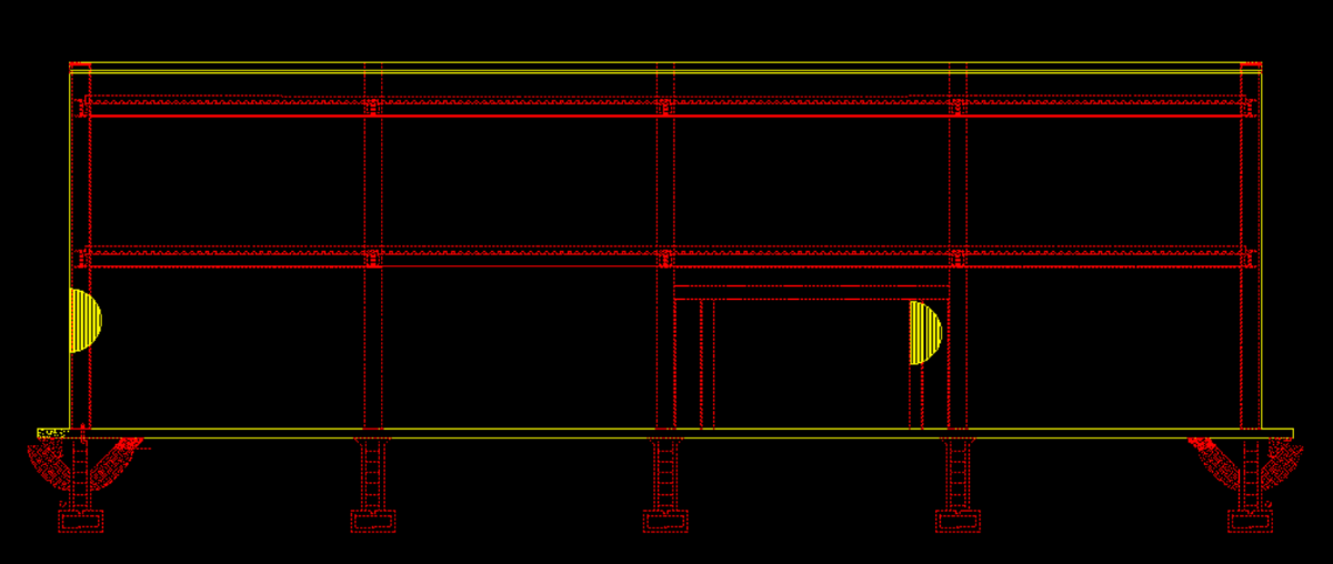

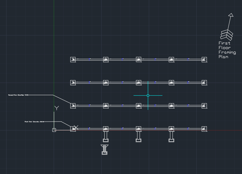

cup2cake28 Posted November 7, 2024 Posted November 7, 2024 This is what I have right now. I have problems understanding Drafting the South Elevation Plan (sheet 2). The instructions say: Some parts of the elevation can’t be accurately described without examining the building’s section. Use the information listed here, then either calculate the additional information you need or draw the building section first to reveal the information you’re missing. The finished grade elevation is 292.90, the first-floor elevation is 293.90, and the second-floor elevation is 305.19. The distance from the top of the footings to the finish grade is 4′-0″. I am having trouble understanding what my instructor means by this. Do I have to split the four levels into their sheets, so aren't stacked on top of each other? Quote
ReMark Posted November 7, 2024 Posted November 7, 2024 (edited) I would suggest you remove any attached drawings from the post above. Why? Because some students might download your drawing and pass it off as their own. When posting to the forum attached screenshots via the Snipping Tool included with Windows 11. As to your question, an elevation view is a two-dimensional drawing that shows the outside of a building or structure from a particular perspective. A section view is a two-dimensional drawing that shows the internal features of a building by simulating a cut (i.e. - section) through it. It is much like seeing the different layers of a cake after you have sliced through it and opened it up. Edited November 7, 2024 by ReMark Quote

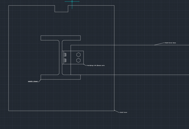

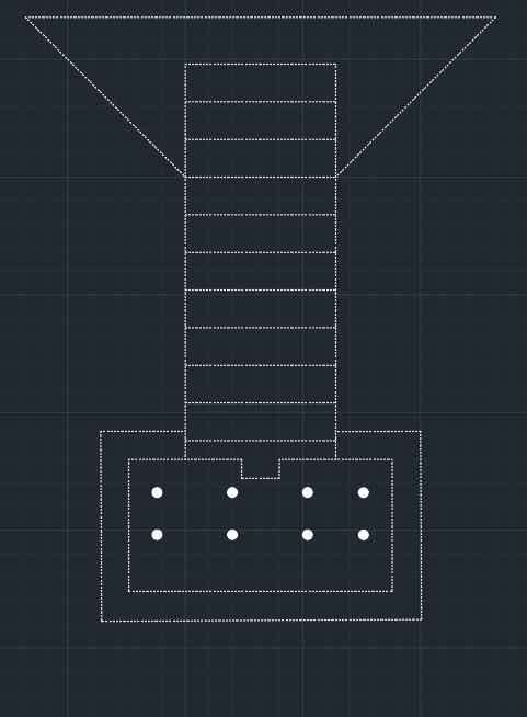

cup2cake28 Posted November 26, 2024 Posted November 26, 2024 Vertical and horizontal rebar is placed in the pier. Notice how the rebar from the pier extends down into the footing—use the same detail here but space the horizontal rebar at 8″ centers. The overlap detail at the bottom of the rebar is 2″ long. This rebar is #6 rebar (3⁄4″ diameter) at 8″ OC. Add a callout for this rebar. Can someone please help me with what my instructor is meaning? Quote
cup2cake28 Posted November 26, 2024 Posted November 26, 2024 Hopefully some of this helps other students Quote
ReMark Posted November 27, 2024 Posted November 27, 2024 Regarding the pier and footing detail. Go to page 2 of this thread. Scroll all the way to the bottom. Now scroll up two posts. You'll find a detail of what the rebar in the pier and footing should look like. Regarding the footing detail shown above. It is incorrect. You have managed to combine elements of two entirely different details into one. I refer you back to the previously mentioned post included in this thread. Quote

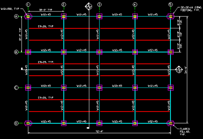

ReMark Posted November 27, 2024 Posted November 27, 2024 (edited) This is my interpretation of what Plate 1 should look like with text, dimensions and section lines. Edited November 27, 2024 by ReMark Quote
